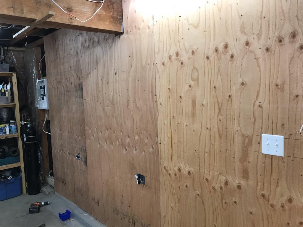

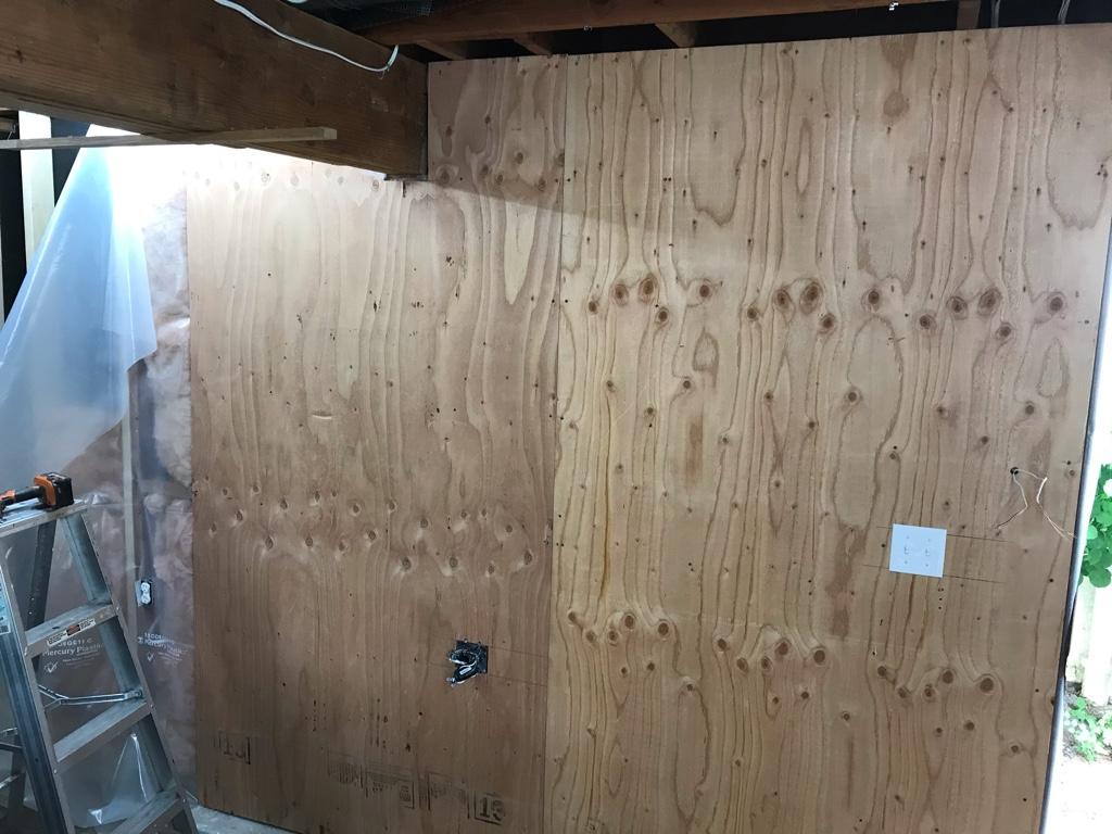

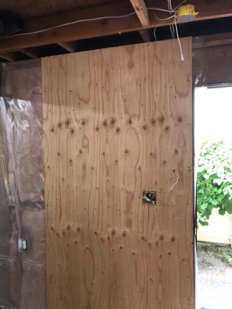

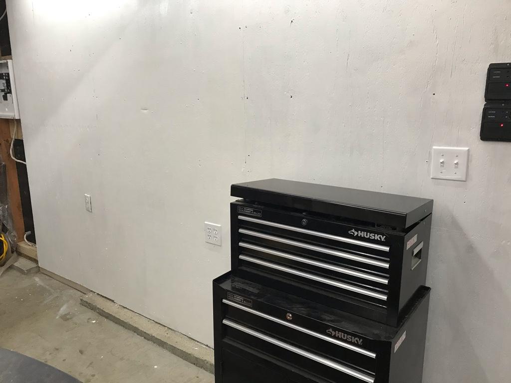

I’ve been bashing away at sheeting the interior of my shop.

Nice. When i built my shop/ garage I did a pretty nice job of finishing it all of with drywall but in hindsight I wish i would have used plywood/ osb sheathing instead, more durable.

I used plywood in my last shop and really liked it. This is going up well. Only messed up cutting the hole for one outlet.

Well I can't say that I envy you after doing ours but it does make a big difference in mine temperature wise we used chipboard and changed out the electrical panel for more breakers.
( cutouts for plugs look like they fit what did you do wrong! lol )

The sheet with the one I did mess up got used in a different location. I had no idea that I wanted a plug there :D

The plywood is a great idea, I find myself putting up plywood to mount stuff to the wall. You're probably going to swear at me but,,,, when I wired my shop I put all the plugs 4' up the wall so I wouldn't need to try and reach down behind a bench or toolbox to get to a plug.

Dag nammit Yota, now you tell me. [emoji16]
Actually those plugs on the white wall are the only ones not high up. The balance are all 50” off the floor.
I have to surface mount ones on the partition wall in the first photo because I didn’t want to drill into the beam.

Godd idea.
I just had a 240 outlet installed and the electrician suggested the outlet be placed about 4ft off the ground. Despite the common sense suggestion I had him place the outlet down low to match the others. This 240 outlet was a surface mount so I wanted the wire down low. If I were to build a new shop I would place all the outlets at the 4ft level.

Yes to 1/2” plywood wall covering, outlets at 44” (same as a kitchen back wall) to accommodate work benches, compressed air line with outlets - I have a filter/drier on the one run and a retractable hose at the far end. I ran that just below upper cabinets with the outlets in between cabinets for access. If you know where your 240 V machines are going you can add outlets as required. I have a centre post and on it is a 120 and 2 x 240 volt outlets for the machines I move around - planer, Edge bander , bandsaw etc.
looking good @David_R8 !

Outlets at 4’ to me are a little low ... coming from a carpentry background, you still can’t lean sheet goods on a wall..
I usually go at a minimum 50” to the bottom of an outlet for this reason (MDO/MDF) are 1” oversized too...
Not as easy to cut out as 48”, but not that hard too... just make a jig/template and router it out, easy peasy.

Thanks @Brent H, it's definitely coming along. I have one wall left to frame in to finish the separate space for the motorcycles.
I also have a centre post that now has a 20A 220 circuit but I am going to move that closer to the overhead door. I'm trying to put as much space as possible between the metalwork and the woodworking areas.
@Bradells I remember reading about MDF being 49" wide so I put my outlets at 50".

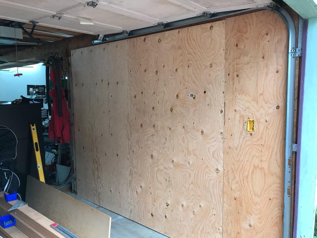

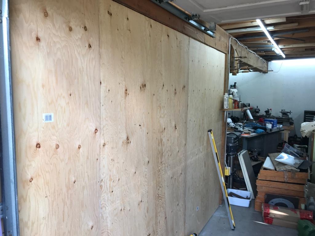

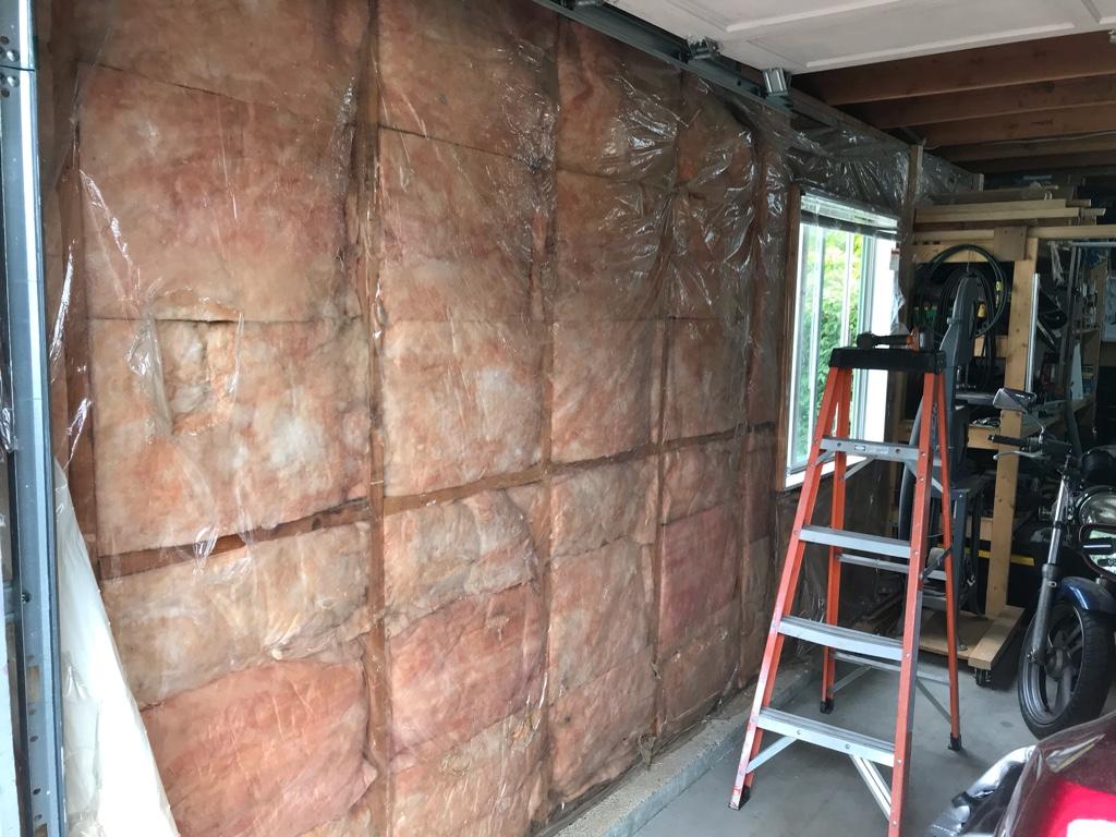

I can never cut the outlets out correctly. 3 left to do on the next 2 sheets for my shop.
I managed to almost pull it off but messed one up.
I was strategic in where I put the outlets so that they were near the edges of the sheets or a solid reference point like a door jamb. That way measurements were were short, under 13” in from any edge. I checked wall studs for plumb and the roof joists for level. The joists were dead level so that became had a level roofline that I used as my reference. Each sheet has less than 1/16"gap and some have no gap so I'm pretty pleased.
