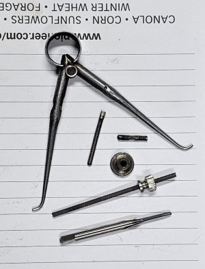

Is using a threading die out of the question?
No, it's a very reasonable way to do it. The problem with that option is that I'd have to go with standard SAE thread profile. If I have to do that, I might as well just get threaded bar and a nut from MC. Which I still might do. I'm not sure how much benefit there is in the Acme thread profile but it is not zero. To rebuild it to factory, an Acme thread is required. To do that, I'd have to single point. Albeit still with a slight thread pitch mismatch.

More and more I'm leaning toward just buying a piece of 2-56 threaded rod and a ball nut from McMaster-Carr. It's not a perfect original repair, but it is more than adequate for my needs.
Even that is not without issues. I'd still have to drill it for the pin.....

But if you don’t use the original TPI you’ll need to modify the nut; if you’re going to do that you may as well up-size the diameter to make it easier to cut.
Can't increase the screw diameter. Won't go through the existing caliper legs which are already thin enough.
I was thinking I could rethread the existing nut from 60 to 56. That would jam over the length of the nut. But, if I drill out half the nut so it's just a tube, the remaining portion of threads might not jam.

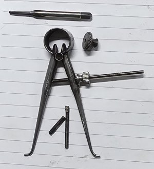

I bought a 2-56 tap, threaded SS Rods and 2 ball nuts from MC. My thought was to drill the rod for the pin and tap the existing nut for the thread after drilling it out a bit (recessing it) so the re-thread has less length to accommodate the difference.

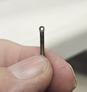

I flattened the end of the rod to make it easier to drill (may have made it worse), center punched it, and then tried to drill it. NFW.
Yes, I have a cheapo sensitive drill chuck and yes I was using my mill and yes I had the part clamped and supported below the drill.
Then I happened to be talking to @Dabbler on the phone about another matter. When we were done I asked about the caliper. He said that his experience with small stainless parts is that they work harden just looking at them. He suggested annealing and then after talking to John Neilson added the need for stainless cutting oil. He also wished me luck with a very sarcastic tone.
He was right to be sarcastic. It didn't work. Could well be my inability to anneal such a small part properly. Or maybe it's instant rehardening on drill contact.
I also tried a tiny diamond dental burr. At first I didn't think it was working. Then my good eye (good compared to my left eye, but poor by any other standards) spotted what looked like dust. So I kept at it for another 6 days..... (actually more like 6 minutes) Success!
Just have to cut off the excess, decide what to do with the ball screw, install the ball stop and polish up the parts.
