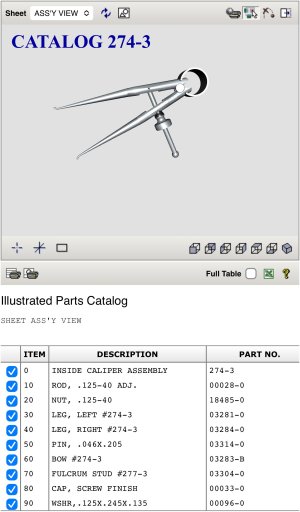

Tool Caliper with broken screw

Holy shit. That Fkn thread is 78.5 thou x maybe 60 tpi. So probably an 80 thou #2 screw. Or perhaps a 2mm x 0.45 or or or.... Gunna need a better way to measure threads I can't see.
Clock makers? Any suggestions? My screw gauge is letting me down.
I suppose I could single point that but I'm not gunna. Just need to find a long screw whatever size that is!

Per the exploded drawing & parts list in Post #5, it's 0.125-40. As I've noted elsewhere ( but maybe not on this forum until now) Starrett hasn't changed threads on these ancient tools to make them standard; in many cases the original toolmakers just used whatever they wanted, or made a tap to suit the single-pointed thread. I have a PT13820 "Upright Post, #196" that is (per Starrett) 0.231-28: I replicated it for a longer rod by using an adjustable 12-28 round die.
No way. Don't care what that reference says. That screw measures 0.0785 it's not even close to 0.125! It could be 40 tpi though.
Sorry, missed your earlier post with the diameter.
