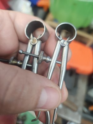

Just had a thought, @Susquatch can you make a new screw with a sleeve end (female) and fit it over the broken end of the screw? You might lose a little travel but you wouldn’t have to mess with getting the pivot end of the screw out of the leg.
You could join the sleeve to the old screw with one of the Loctite bushing retaining compounds. There certainly wouldn’t be much loading on the joint. You might be able to join the two halves of the existing screw with a bushing too. Maybe a nice shiny brass sleeve that shows that machinists can fix things elegantly. ;)
The problem is that it's broken right at the middle of its travel. If I did this, I'd have to cut the remaining screw very short. Even the sleeve would have to be short and just at the very end. The new screw would have to be integral to the sleeve to yield enough thread. But it is a possibility. If I did that, I'd prolly just use steel epoxy.
If they were being very clever they could have drilled down the leg from the top then fitted a plug with a feature to retain the screw cross pin but again I don’t see any witness marks.
No, the pivot is the other way.
You have to appreciate the skill of “the old guys” who did this kind of work before all the modern technology came along!
Amen to that!
Looking closer at your photo I see now that it didn’t break at the end of the thread like I thought so you would have to shorten the stub and make another adapter screw to get more travel.
What I meant was the screw with it’s integral pivot pin would be slid into the slot in the leg then rotated 90*, then a forked retainer would be slid into the top of the leg to capture the pivot pin. Kind of hard to visualize without an image but doubtful that that they did something like that too.

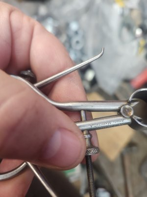

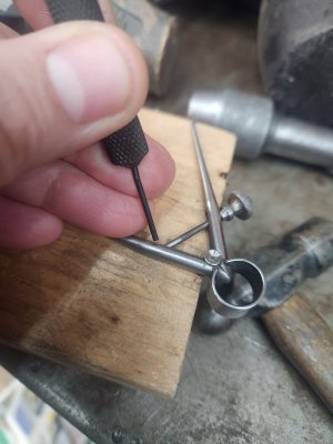

It should be pretty easy to approximate the position of a pivot pin. I'd take a small punch, and with the arm supported in a vee/bench block start tapping gently around the area and I'm almost 100% sure a peened in place pin will reveal itself. Should be straightforward from there.
Ok, I just tried my advice above, and I'm now in the magic camp too......lol
There,s a good chance I didn't hit hard enough to dislodge a pin, but I really didn't want to go marking it up either. Just some very gentle tapping around the highest point of the cylinder, with enough force that I thought would have surely dislodged a peened pin even just slightly, but not enough to mark up the punch, but i got nothing.
There IS a very slight indentation around that area on my outside calipers though.....Witness from a pin? or box rash? Tapping there did nothing, same as the inside caliper. But then I don't really want to hit any harder. If the broken one were mine, I'd go for it. You're going to repair it with a pin most likely, so damaging that area from a punch isn't really a big deal. And It's already broken anyway.....To me, that really looks like a pin.
Looking down into the opening, there is almost certainly a cross pin in there providing the pivot, not a ball. Whether they drilled and peened it, or it's integral to the screw and they swaged it closed it the $10 question though.

Well Dan. Turns out that you and a few others were right after all. You should have another look at the side opposite of where you tapped on it.
I couldn't see a thing. But I ran my finger ever so lightly across it, and I could feel an edge I could not see. I know for an absolute fact based on many experiences that can feel things I cannot see. That's another reason I like my lathe standard. My fingers can feel a few tenths.
Anyway, I could feel the edges of a pin I could not see, so I got a bit more aggressive with the punch and...... Magic!
The rest is easier. Just need to drive it out the rest of the way, find a long screw with the right thread, and make a hole in it for the pin!
This problem too was simple when solved!
