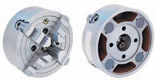

Tired of my 4 jaw that came with this lathe and the lack of accuracy and usability, I decided to try an accusize 8” 4 jaw.
Had to machine the faceplate, got it within a thou.
I'm struggling with this one. I'm not sure I understand what you are complaining about. The runout on a 4-jaw chuck body is pretty meaningless unless it translates into jaws that are canted or off-plane. Can you elaborate on the problem and the way it manifests itself when you mount parts in the chuck?
@Susquatch the chuck is mounted on a threaded adaptor. It is off enough that if I try to get the lathe going anywhere fast enough for smaller work pieces then it is off balance enough it vibrates the lathe.
The new chuck I can get up to 2500 rpm…..
I’m not super into fixing that old threaded chuck. It also sticks out a great distance off of the spindle due to the adaptor fiasco, giving less rigidity.
It has 1/4” square screws as well which means a lot less torque.
All in all, it just has been a thorn in my side since I bought the lathe, and I dreaded having to use it.
The new chuck after testing today is MILES better in every conceivable way other then the old one has a cool factor, and is made in the states.
I’m sure someone with an old threaded spindle will love that old chuck.
I’m stoked about my new one.
I think 2500 is getting up there for an 8" chuck which is dialed in quite concentrically (as opposed to holding anything off center with inherent imbalance). Even so I'm not actually sure if that recommendation pertains to the chuck in isolation or makes any safety presumptions the typical lathe spindle / bearings supporting it. Offshore chucks can really vary in quality, sometimes even across the same brand. There are posts here on the forum about some with casting deviations causing imbalance to the extend what was stamped on the face was wishful thinking. So just go easy or better yet try & set it up on a rudimentary balancer. Bad vibration is not kind to your $$ bearings. I you are chucking big things you wont be spinning that high anyways. If you bought it for dialing in accuracy on shafts, probably better to have a smaller chunck, which is less mass (but another chuck of moola). I bought a 5" 4J primarily for my RT but actually I like using it on my lathe, the big boy only comes out when I have to. Anyways, those are my thoughts.
Bison says 1800
Gator says 1800
Shars has an offshore that says 2100
I think 2500 is getting up there for an 8" chuck which is dialed in quite concentrically (as opposed to holding anything off center with inherent imbalance). Even so I'm not actually sure if that recommendation pertains to the chuck in isolation or makes any safety presumptions the typical lathe spindle / bearings supporting it. Offshore chucks can really vary in quality, sometimes even across the same brand. There are posts here on the forum about some with casting deviations causing imbalance to the extend what was stamped on the face was wishful thinking. Sojust go easy or better yet try & set it up on a rudimentary balancer. Bad vibration is not kind to your $$ bearings. I you are chucking big things you wont be spinning that high anyways. If you bought it for dialing in accuracy on shafts, probably better to have a smaller chuck, which is less mass (but another chuck of moola). I bought a 5" 4J primarily for my RT but actually I like using it on my lathe, the big boy only comes out when I have to. Anyways, those are my thoughts.
Bison says 1800
Gator says 1800
I guess the Accusize Website only claims 2000. So good to know.
I had it up at 1500 ish rpm just to test with a dialed in piece.
Ya, I wanted a general purpose 4-jaw and I had the other 4 jaw, I liked the size of it and it seemed good to have something for bigger stuff as my 6" 3-jaw is nice but has been too small for some stuff.
The new chuck does not vibrate. Very smooth. You can tell it is alot of mass however.
There always is another thing to buy..... I wish money was as abundant as my ambitions.
I will likely make do with this 8" 4-jaw and my 6" 3-jaw for a good while now.
But a smaller 4 jaw is a nice idea.....
I see. So you are talking about vibration not part runout.
Somehow I also got confused when you said your old one was d1-3. Or is that the adapter you mentioned?
Maybe i'm not the best with the terms.
It has a threaded adaptor going to a d1-3 face plate thats been modified to accept the threaded adaptor, then the chuck is threaded to the threaded adaptor. The whole thing is 8" ish long.
Yes, vibration.
