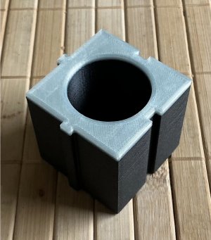

I had a need for the tripod today so I decided to mill an adapter from aluminium. I was taking measurements when I had this idea to look on printables and other 3D model websites.
Sure enough there were several. So I picked the one I liked best and tried to print it. No good. This particular model doesn't print directly. I had to slice it first using the desktop program. No biggie, I did that and told it to go.
15 minutes later I had an adapter in my hands. But..... It was too loose on both X and Y. Back to the slicer and stretch x & y by 3.5% based on measurements of the shoe and the printed adapter. Ya, not yet buddy. Now it's too tight. Actually, it could be forced, but easy peasy to print again at 3%. Plugged it in and pressed go.
Fits perfect.
Just need to add a 1/4-20 thumbscrew and drill for it.

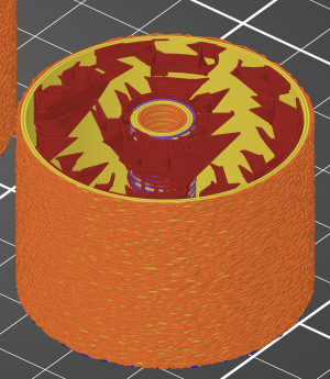

Like this roloc adapter - I print it with many perimeters - 20? - so it is a strong as possible. with fewer perimeters it just breaks.

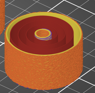

Here is the inside of the roloc adapter with 2 perimeters - you can see the infill but the part is mostly hollow. There are 2 perimeters on the outside and 2 on the threaded ID (plus a couple more for the thread form).
And here is the adapter with 12 perimeters - you can see it's much denser.

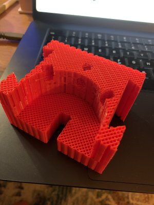

his is interesting - this part is printed without walls, no top and no bottom layer, or more simply with zero perimeters. Just the fairly dense infill is printed.
Essentially infill is like honeycomb, but not constrained to hexagonal cells. There are all kinds of available infill patterns to choose from.
This is interesting - this part is printed without walls, no top and no bottom layer, or more simply with zero perimeters. Just the fairly dense infill is printed.

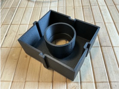

Right after that print, high on adrenaline and confidence, I tried to print a 9 hour job of dessicant boxes for my AMS. 17 parts altogether. Other than the front left corner part that made a gooey mess on the inside corner of the part, it printed fine. All the lids fit and the breather holes didn't leak dessicant.
BUT,,,,, Nothing fit my printer. NOTHING! Wrong kit? Did it remember my scaling for my quick mount? WTF!!! 9 hours wasted!

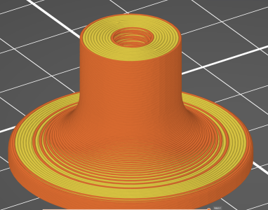

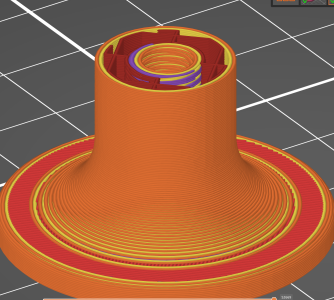

The different patterns are weaker/stronger and of course slower/faster to print. Some are water proof, others are I think mostly just interesting. I've been using the lightning pattern to speed up print times. Below. You can see there is no infill towards the bottom and the infill grows from the sides to support the top layer. I also turned on the fuzzy skin feature you can see on the outside of the part.
here is Archimedian Chord, or spiral. If you turned off the top and bottom layers then it could be a circular spring.
