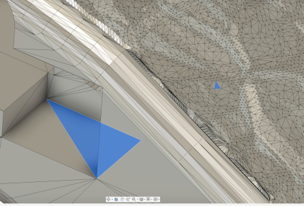

I downloaded the collet holder I printed into Fusion 360. It came through looking like this.
Doesn't look like anything I've ever seen before. What the heck am I looking it at?
So, can that be edited? Say to turn a 4x2 block into 10 x 4?
I have not done much editing within the slicer app itself, but I think you are somewhat limited to scaling or stretching in different dimensions, maybe mirroring. Others may have more experience here.
What you are asking is the classic question that comes up. Editing STL inside a CAD app is possible but depending on complexity its typically more of a headache than modeling it from scratch to get exactly what you want. The reason is you are dealing with a surface model & STL is considered a clunky CAD format because its mesh facets & depending on how it was exported, maybe even 'rough resolution' mesh facets. STL is a convenient export format for 3DP but its not a common interchange format between CAD apps unless we are talking kind of non-mechanical things with less constrained geometry & dimensions. Surface modeling is kind of a seperate module or way of generating objects inside CAD. In many respects its more complex than solid modelling although some parts may well require some of each in a part. Now if you had a STEP file, that is more of a CAD friendly export file & you stand a better chance of importing into your modeler of choice, editing/modifying.

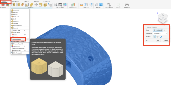

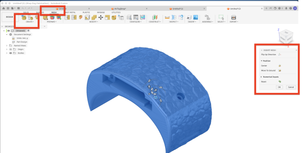

If what you have is an .STL then in Fusion, @Susquatch and ALL - there is another tab in the tool bar for "MESH". Here you can find tools manipulate .STL . I have not explored this much - having the CAD file and importing that if you want to change is far simpler as Gerrit outlined. One key thing I will point out is the convert from mesh to body option which makes the object easier to manipulate back in the "SOLID" tab.
Upload STL to fusion here in the MESH menu
Convert Mesh to Parametric object. It's still not easy to manipulate - like this many triangled bracelet stl below - challenging to change it beyond simple ops like scaling or cutting into pieces. Easier and quicker to redraw it parametrically.

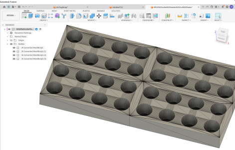

Here I uploaded the .STL and converted it to a parametric object like above. You can see each triange is it's own face. It's very complicated.

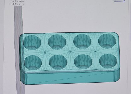

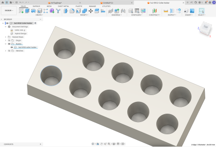

That looks similar but not quite the same to my ER32 model on https://www.printables.com/model/292591-er32-collet-holder-tray
Here I uploaded the .STL file, converted it to a parametric object, and used the rectangle pattern to make 4. It's super slow because the objects are very complicated with thousands of triangles. It would be much better to draw it again, or perhaps ask the designer for a copy of the original CAD file?

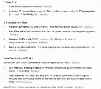

20 a month sounds ok but it is only 2 projects a month if you have a more complicated project @ 50 credits each. 10 simple jobs at 10 credits each sounds better but if you are doing something iterative it could add up quickly. Might be worth the free trial.
