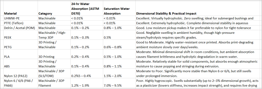

Not one, but two potential issues related to the hygroscopic nature of a plastic.
Nylon is our worst printing filament.... but there are cases where it's hygroscopic properties are beneficial too such as for living hinges, or gears.
Post printing nylon is dry and brittle, but a warm water bath makes it flexible....

I agree, even with blocks of plastics you can't always account for the moisture content.
I have had an experience with machining a piece from the end of a bar of Nylon 60 and making a thread protector for my lathe spindle. It initially screwed on quite nicely, then as the weather got better and warmer the thread protector got really tight, at one point I thought that I was going to have to turn it off the spindle. However a pipe wrench got it free. I had to re-cut the threads several times before it fit comfortably as it did before.

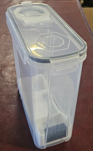

For the most part I've been buying brand name Fillament and transferring it to a Tupperware cereal box with a dessicant tray / spool stand on the bottom of the container. The tray has a slot for a small square humidity meter.
I think I'll just continue my practice of storing my filament that way and keep an eye on the humidity of the air in the container. If it fails to dry out, or the dessicant changes colour, I'll refresh the dessicant.

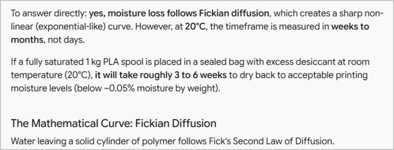

With just desiccant drying how long does it take to dry a spool?
Here is the problem...
While your desiccant will suck the moisture out of the air in your container at room temperature, the filament resists releasing moisture, to use my analogy again, at room temperature the variable speed pump is throttled right down.
Sound rules are, do not open filament until you need it... and then pop it in a heated drier before use to condition. Then seal it up after use.
Desiccant is a protectant, not a cure.

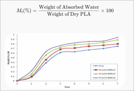

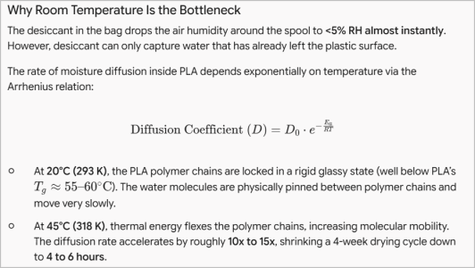

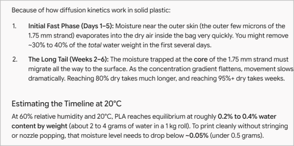

Trying to recreate what I AI-d before but this is the gist of it. I said if my max humidity was 60% at 20C shop temp & assume fully saturated filament because it was sitting on the printer for a long time, how long would it take to remove water in sealed bag with sufficient dessicant at same temp. In reality this is worst case, my humidity was 17% in winter & averaged 35-40% in the summer except for monsoon when it ent to 60%. But othergeographic areas could be much worse on average so that has to be accounted for.
I learned that not all PLA is the same, but typical PLA+ or Bambu basic is more like PLA90/100 (blue) curve. The graph shows diminishing returns, 5 days only gets you 70% water removal on mass basis. Obviously I was lazy enough to leave the spool exposed on the printer for a week, so properly storing in the sealed bag for the same time or longer seemed like my simple approach would do some good. Note that a 500g spool will not dry faster, the chart is on a filamant mass basis. Supposedly the outer filaments will be drier than deeper in the spool & outer filament will be first to enter the nozzle. This is because deeper in the spool, the moisture path has a longer more tortous path to get 'out' past its neigbour filaments towards the air/dessicant. Its small bonus points that work in favour but not not really the big picture. Possibly it explains when people say the first prints was great then it went for crap on the exat same job..
But as per the last screen grab, room temperature is the bottleneck on the simple bag method. To accelerate the water removal process you need to raise temperature which increases kinetic energy = a dryer. So if you are constantly swapping spools & wanting the the best filamant conditions, it requires a step up meaning elevated temperature control IMO.
