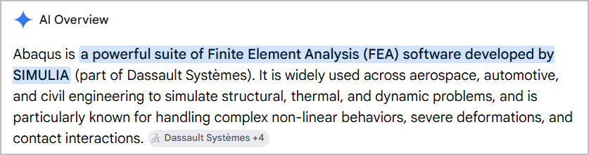

OK, so now I have 3 or 4 CAD packages to evaluate. FreeCAD, Fusion 360, Alibre, and maybe Abacus - whatever that is but mentioned in the same sentence as FEA so....
I sorta like that FreeCAD is affiliated with Dassault (Catia).
Just to clarify FreeCad is open source CAD, nothing to do with Dassault. Abaqus (FEA app) appears to have been developed by or has lineage to Dassault based on random Google search. Not quite sure how it became available in public domain to be a workbench module to FreeCAD? Usually Dassault specializes in monetizing next weeks air you breath & unleashing its lawyers on any licencing infractions to its product line. Maybe licencing its use or...? Dassault of course runs CATIA & Solidworks & Solidworks Maker & a sh*tswamp known as 3DExperience

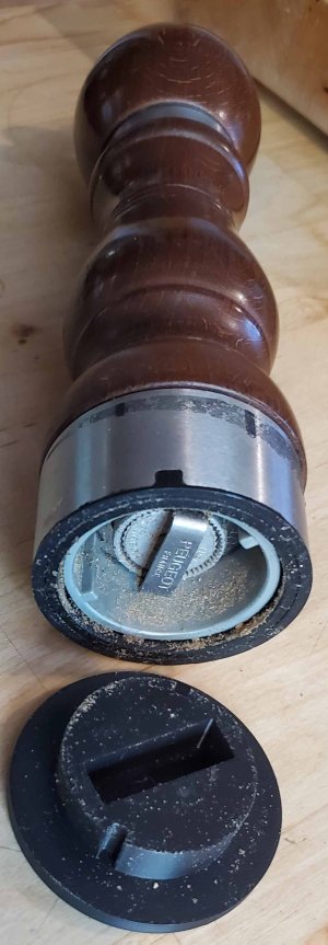

The other day my wife asked me to fill the pepper grinder again. It's old. For some unknown reason, compared to when it was new, the grinder part drops further down, the peppercorns get caught in the gap and then the screw at the top is now too low to attached to the threaded ball retainer at the top.
Anyway, normally I just hold it up with my finger while we pour peppercorns in from the top. Kind of clumsy. Then the 3D print inspiration hit me. Something to set the grinder on to hold up the grinder wheel and then just fill it from the top. The threaded rod won't drop.
Out came the calipers, Angle gauge, a bit of AlibreCAD and 3D print. This is the end result.
Works like a charm. 45 minutes printing but only 10 minutes CAD.
