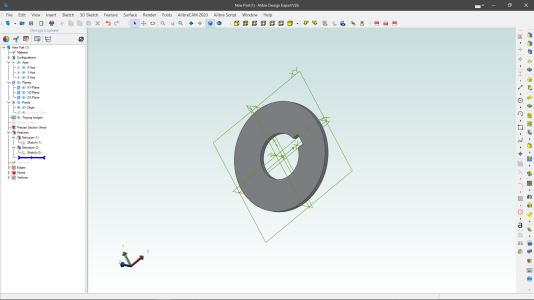

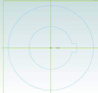

I drew the two circles, added the square but I dimensioned it to be 2mm from the horizontal line, achieving the same thing as the symmetrical constraint.
Trimmed off the bits of the square that were hanging out in the bore and extruded it.
Now make it 45mm diameter with a 19mm hole and 5mm square key.
I changed the OD to 45, ID to 19 and changed the 4mm dimension to 5mm. The other side of the key was based on the first so everything was easy to scale.
This makes a bit more sense.
But why do you need to trim something that isn't there? Didn't you take a square chunk out of the washer? Why isn't it just a square eraser? Can't you just choose draw, erase, trim, chamfer, colour, etc, then what shape, then where, etc etc?

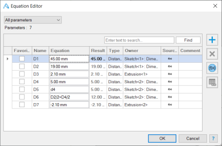

While editing a sketch click on the dimension.
Then click on the f(x) button.
Here are the parameters
D1 and D2 are the OD and ID. D3 is the Extrude Boss value to make the washer 2.1mm thick.
The D4 represents the thickness of the key slot in the X direction. Since it's a square key the Y direction is the same so instead of choosing 5.0mm it's easier to use D4.
And that's why I used the constraint to put the two horizontal lines to be symmetrical about the X axis. A distance to a line is now not needed. Although you could also use D4/2=2.5mm above the X axis instead of the symmetrical feature.
Finally the depth of the keyway is based on the two dimensions so change one of the main dimensions and the position of the keyway changes.
If I wanted a 6mm key I can edit it in the Equation editor to be say 6mm and now the broach will need to be 6mm instead of 5mm to cut the keyway.

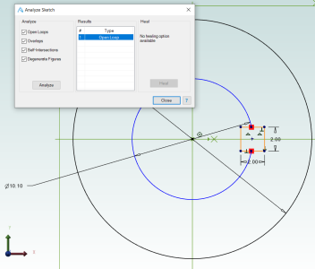

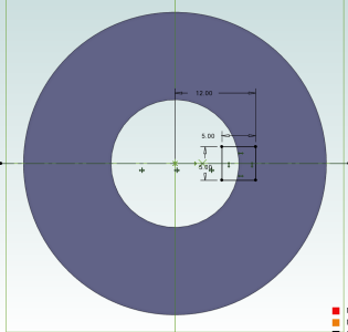

It's a different way of thinking. All the Parametric CAD systems use similar ways of doing this.
With respect to the blue circle the problem was the screen shot didn't show up on the posting. I had to back track and recreate the screen shot and edit it in.
The reason @DavidR8 had to take it out is because these drawings can't have open loops or odd lines hidden by others. Something to do with rendering them in the future or even creating 3D print files.
So to not have this error you have to do remove the square on the inside.
Now this can be extruded up into whatever thickness you want.
But when you talk about erasing it's done the way I did which is draw a square on top of the disk and then used the extrude cut in the negative direction to remove the material. That's parameter D7 in that above screen shot.
