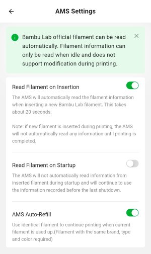

Is that an iPhone app John? Seems my app is different. There is no 4th option.
Maybe if you enable read filament on startup it might then add the other checkbox.
Didn't work. I'm thinking the AMS version works differently. Odd that the older one works but the newer one doesn't. I'd bet they got complaints cuz it wasn't accurate so they dumped it.
I'll prolly just weigh them to know for sure. I might also start a log to keep track of what I use. There is a filament library in the handy app and prolly in the desktop program too. I wonder if that has notes for such things.

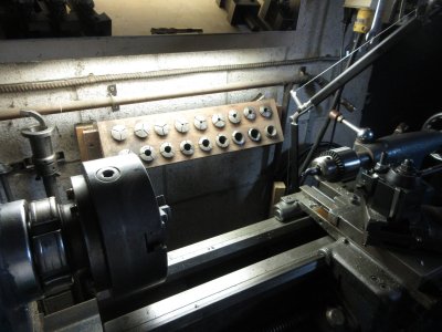

Here is my C5 Collet holder. Made from a Black Walnut log that I milled and came off of the Niagara Escarpment. Took 20 minutes to make, finished with WD-40. No Smart Phone App required.

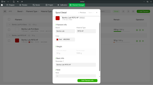

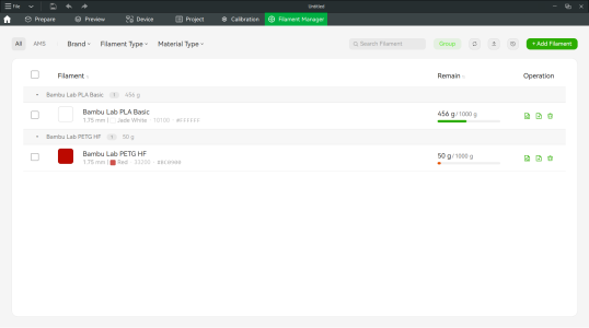

It has to be there but just not properly initialized. In fact my PETG black spool listed 0gm and black. I clicked on the left icon of the 3 on the right.
And then Edit Filament Info button on the bottom. Changed the weight to 50gm and colour to red. We'll see if it sticks. Need to think of something to print.

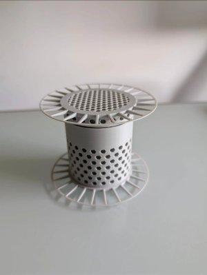

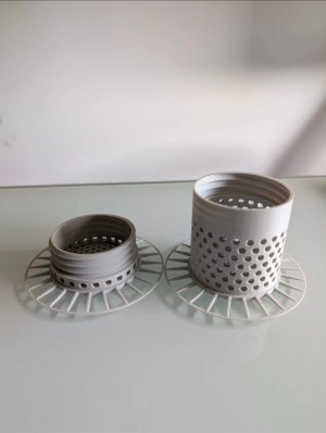

The good news is that I'm getting there. Yesterday, I made this:
It's a dessicant holder that fits into the center of a filament spool.
Can't make that out of Walnut.
There are other ways to dry filament of course. But that isn't the point. The point is to make things with my 3D printer that can't be easily made using conventional methods AND to make prototypes for evaluation of my ideas and design concepts. As others have said and I am learning, the former is probably already available somewhere on the many 3D model sites. The latter requires me to learn a 3D CAD program. Even if I never get to the latter, the former will be enough to make me happy. Be nice to get the win-win though.

Yes, I could turn the basic shape on my lathe. But all those holes would drive me crazy.
The whole thing including holes and threaded cap was on MakerWorld. I just used a google search to find what I wanted.

I was about to start printing this one when it dawned on me that Bambu spools have a larger hub diameter than some of the other spools I have.
I found this one that has a smaller diameter variation for other brand spools.

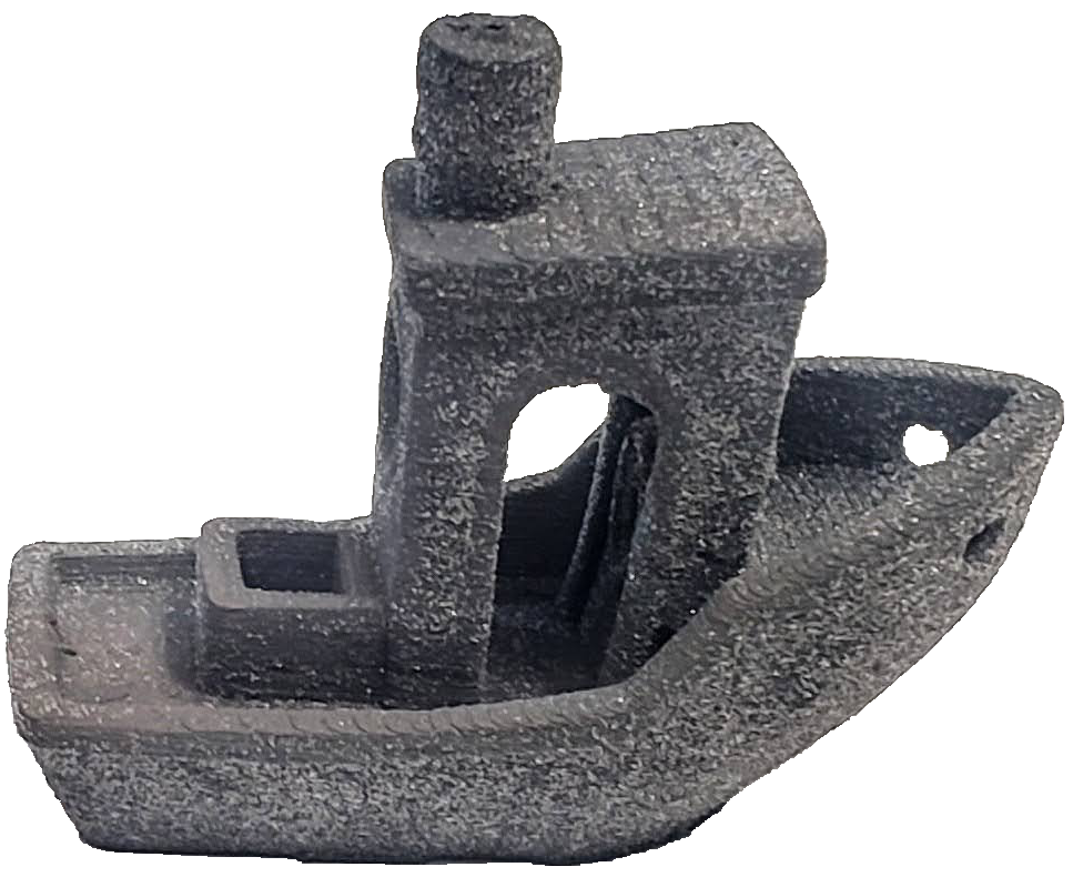

No Bambu lineup cannot print metal. The typical industrial process is Laser Powder Bed Fusion (LPBF) - DMLS (Direct Metal Laser Sintering) or SLM (Selective Laser Melting). Mike on our forum had some nice model engine heads made through a service you send CAD files to. Its getting less expensive & better all the time. But its a mass/time based pricing thing so expensive for large things. And pro's & cons depending on the part.
I have read about metal infused 3DP filaments but I dont think its a hobbyist level thing yet. It has some industrial level associated processes to sinter/support etc AFAIK
Can the Bamboo print metal?
Nope, the Bambu can't do that. They were working on a sintered metal system back when I was still in industry. As @PeterT says, it's here. But not in my pay grade.

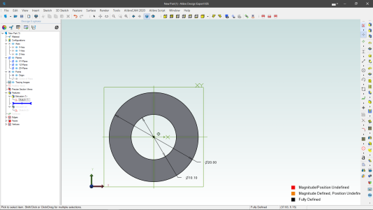

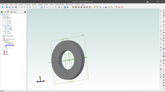

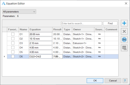

Rats. I need a washer for a repair project. Needs a 10.1mm hole, 2.2mm thick and 20mm diameter. What to do...
Normally I'd go straight out to the lathe and work off a paper sketch. Hmmm. Sketch... Using my older Alibre Design user interface...
First a circle that is 20mm diameter. Notice the highlighted blue circle on the RHS.
Then the second circle for the hole that is 10.1mm diameter.
Then we extrude this to 2.1mm thick.
Then save and also save as an STL file to be able to 3D print a sample.

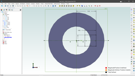

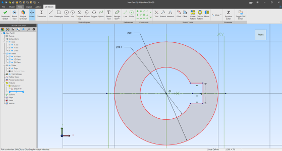

Oops... I forgot, I want a slot for a 4x4mm key that has 2mm into the ID of the washer.
First draw a 4x4mm square.
Next we need it symmetrical on the axis.
So use the symmetry tool.
Finally we want it 2mm deep. This is a place where we can use the concept of parametric CAD. The diameter of the hole is 10.1mm so the depth of the slot would be diameter/2+keyway/2. But what if I change the hole size?
Results in

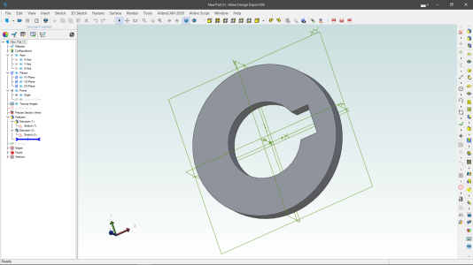

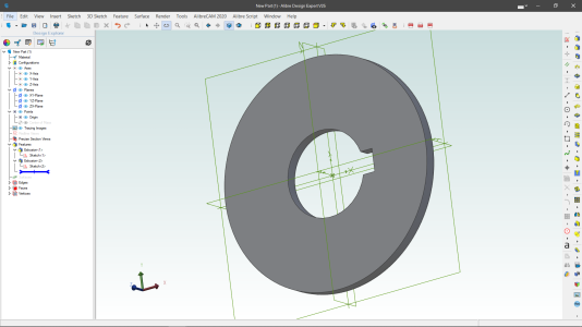

Now just extrude cut.
Now if I want a 40mm washer that has a 15mm hole with the 4mm key I change two parameters; the outer diameter and the hole size in the first sketch. The key slot is still the correct depth.
I'll let @DavidR8 do the same thing using Alibre Atom.

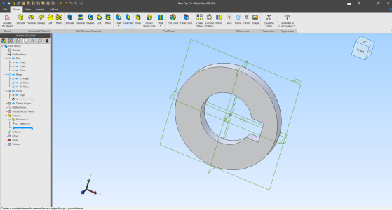

@jcdammeyer
I drew the two circles, added the square but I dimensioned it to be 2mm from the horizontal line, achieving the same thing as the symmetrical constraint.
Trimmed off the bits of the square that were hanging out in the bore and extruded it.
