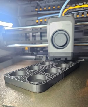

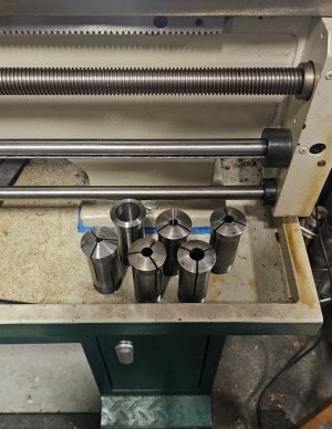

In the meantime, I am printing a small 2x4 tray to sit in my lathe splash pan where I normally keep a half dozen collets anyway. It is already half done as I write this.
I also had my first problem. I loaded the collet tray model, made some changes, and pressed go. I clean forgot to remove the filament prime line from the previous print. So I had to run out to the shop and pray that it didn't crash. It didn't, and I safely removed it before the print actually started.

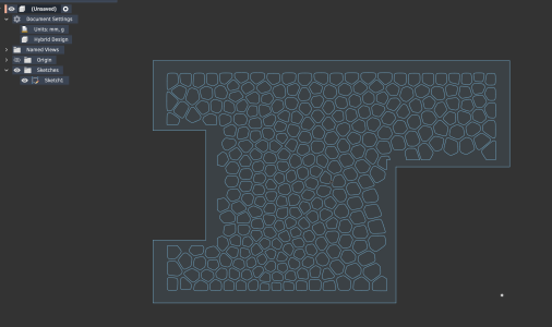

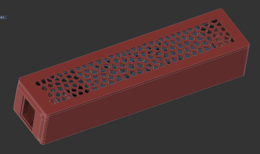

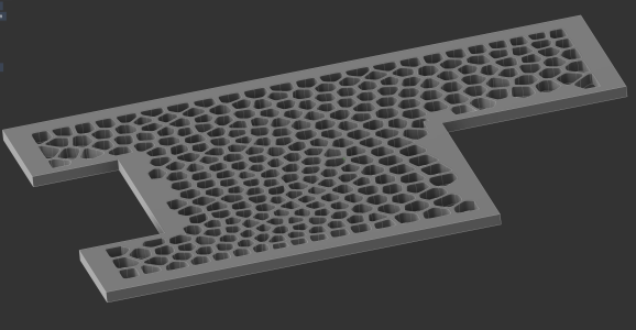

Vornoi is a pattern of "random" holes arranged to fit within a boundary.
This one is a power supply housing with vents.
In you favorite CAD system there will usually be a scripting, extensions or add-in option. Vornoi generators are available from independent developers as add-ins, to create sketches with the "holes" auto generated. Extruding the sketch profile creates a solid.
I find this useful for decorative patterns, ventilation, weight-reduced panels, lampshades, etc. The Vornoi pattern adapts to the shape you need to fill.

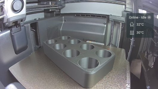

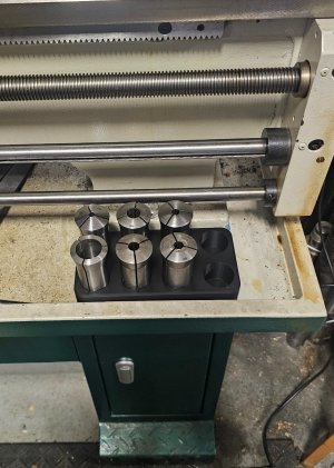

And here it is where I wanted it. Very nice. I was tired of collets falling over all the time, but I like the standard sizes handy. So this looks after both wants.
As mentioned earlier, I'll do the CAD modification iteration another time.
PS - this part practically fell off the plate after it had cooled.

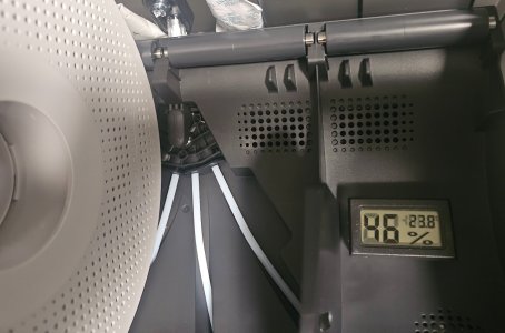

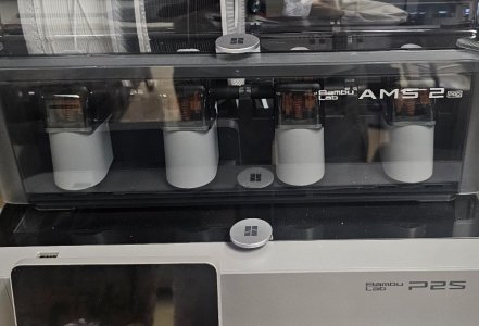

Here you go John. My AMS is what Bambu calls an AMS 2 PRO. The tubes are high in the cavity. Not much room at all.
Compare that with upfront between the filament drives.
Those 3 spaces in the middle between the filament drives are about 10in3 each with two 5in3 cavities on the sides.
So in looking for desiccant containers you'll have to include AMS2 in your search to make sure you can print up something that fits.
