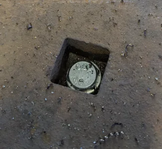

It's one of three heavy 4"x1.5" cast bar 4' long with these convenient recesses cast in:
So I use those to hold it to the table, rough one half out, slide it down the table and rough the other end. Turn it over onto parallels, do the same, then turn it a third time and take a finish pass. It won't be perfectly straight, but close enough?
The cuts the carbide inserts can take while being cooled are just astounding to me.
These are going to be the rails for a lathe a friend is building - I'm thinking "incredible overkill" while he's thinking "they were free!" But either way I'm impressed by what this mill can do.

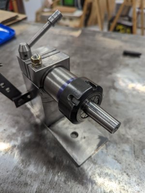

Inspired by a @140mower's recent post, I got into the shop to make up a new spindle for my indexing jig, going direct to ER32 instead of stopping through MT3 on the way.
New spindle shows about 4 thou runout on the work and much higher rigidity. That's a huge improvement over the first spindle.
I used @140mower's collet-on-a-rod trick to set the angle and it just worked a beaut.
Incidentally, this was the first "real" threading I did since putting the electronic gearing on my lathe. Set it to metric, 1.5mm pitch, set the compound angle and engaged the lead screw. Motor in reverse to back out, and it all worked perfectly on the first try. I'm now *really* surprised not to see small lathes out of China with this hardware built-in. I guess the servo costs just enough more than the change gears to not yet make it worthwhile, but that's only if the buyer doesn't count their own time.
Another benefit: too heavy a cut slips the lead screw drive belt instead of crashing the carriage. If I was really clever I'd figure out how to size it properly for high torque and decent safety.
