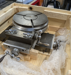

And when I got back, a heavy but small wooden crate was awaiting me:

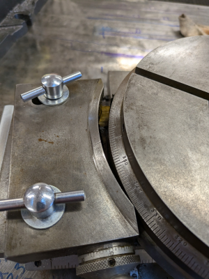

She's a beaut. All three axes are buttery-smooth. Also has an interesting gear-engaging mechanism where the block housing the lead screw swings out:
I haven't figured out any locking mechanism for the rotary axis, however.
No commercial marks on it, and it could all have been done in-shop. Came to me from Nova Scotia.
My Sowa RT works like that too. Very different, but works quite well. I like it.
Never saw a three axis RT before. Only ever saw one or two. Really nice! Congrats!
3 axis on a mill is somewhat redundant, but that would be awesome on a drill press. Good catch.

Where is the rest of it?
What's the back story?
Do you know what you've got there?
PS .... lock is via two nuts on the underside of the round bit, as shown

That's all I have. There's not much back story - a friend of a friend spotted this somewhere around Wolfville at what seemed a reasonable price for a rotary table in good order, so I took a chance.
It sounds like you might be able to tell me what I have ;-)
Paul
Yes, its the X/Y and RT off a BCA jig borer. They are a highly regarded solid little jig borer more than capable of milling (given they have dovetail ways vs box) Any chance of back tracking and finding the rest of it?
The BCA jig borer was the British version of German Boley jig borer. There were a few manufacturers of it. The story was something like the war office let out the design and contracts to various manufactures as lots of high precision machines are all of a sudden needed. Bomb insights, instrumentation etc. Mine was made by Sigma Jones (instruments) which I think Tony's site mentions was one of the more highly regarded makers.
Really lucky with mine; it's like new with scraping marks visible on all surfaces etc. I have been doing tons of modifications to it. Built a new Z axis "platform" using T slots, built a new spindle as the original used really hard to find collets, dro, oilers and channels on all surfaces, replaced the motor with a DC motor, replaced the X & Z axis bearings with ACs, and so on. It's almost done, but will likley end up selling it as it duplicates some other acquisitions. Kind off irks me that it turned out that way, years of work, but its a self inflicted injury.

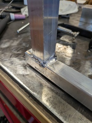

But the TIG is starting to look better:
This is the first corner of a tonneau cover for the golf cart. I've done worse. On the second corner.
At least I know more of what to look for when watching the puddle.
