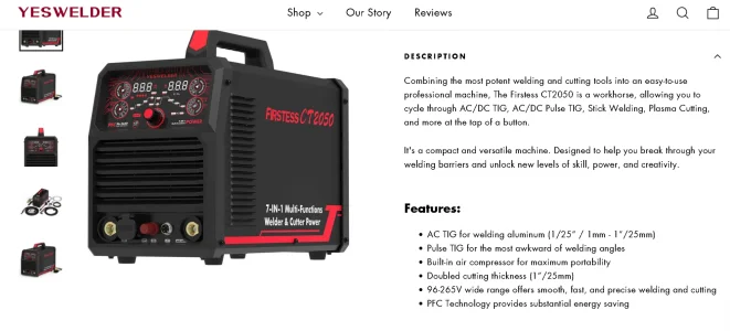

I'm not sure how well one of those would perform, but it looks like you would get the most bang for your buck out of only $1000. However the lower capability of each process as well as the plasma cutting, would not really pay off for me buy how far I am planning on taking my welding and cutting skills.
In addition to the Chris’s five, it also shows that it does AC TIG (for aluminum). I’m guessing that the manufacturer indicated seven because they are including the built in plasma air compressor. That machine has an awesome spec sheet but that’s a lot of eggs in a Jack of all trades basket. I have not heard of that brand. It will be very interesting to see an independent product review, not just functionality but also service and reliability.
