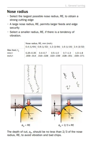

I did a bunch of research on insert tooling and one key learning was that the nose radius is the minimum depth of cut. This has a lot of implications for us small lathe owners. If the radius is too large then there's a good possibility that the machine won't be able to make that depth of cut.
All of this lead me to use HSS far more than insert tooling simply because I can keep it razor sharp and take depths of cut that my South Bend 10K can manage.

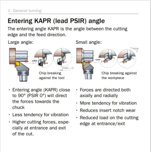

Also, have a look at those red arrows in the Sandvik Nose Radius picture. The size of those arrows is of significance! With a shallow depth of cut, relative to the nose radius, the radial forces created are larger than the axial. This will cause chatter, especially with slender parts. But when we take a deeper depth of cut, relative to the nose radius, the axial and radial forces are almost equal, therefore far less tendency for chatter.
The same goes for lead angle. If we can have the majority of the forces directed towards the chuck, we should have less chatter, than if we had a tool entering at less than 90 degrees.
(The picture of the "Small Angle" doesn't really describe this well). In the picture of the 90degree lead angle, the vast majority of the forces are directed towards the headstock, (the heaviest and sturdiest part of our lathe), but with the "Small Angle", in the shown example 45degrees, the forces are directed towards the chuck and towards the part equally, therefore the resulting forces are off on an angle which would increase the propensity for chatter, especially on slender parts.

The illustrations posted above are for optimum cutting conditions. It is very difficult to have every style insert, radius and holder at your disposal doing this as a hobby.
If you go by the book and illustrations above in order to find optimum cutting conditions for each part your machining in a hobby shop. You will be upside down on costs, along with piles of headaches trying to achieve the optimum cutting conditions in all types of materials.
Then you start thinking do I need a 90deg holder, 95 deg, 93 deg and so on.. looking for that optimum cutting condition.
Try not to let the " catalogue " mess you up.

When turning with inserts. DavidR8 described it perfectly as mentioned above. If you have a .015 rad, take a minimum .015 DOC and so on.
I would say stick to insert rads that your lathe can handle in depths of cut. I can't say I follow the rules all the time thou..

The main point being that if you are using insert tooling, the nose radius is going to determine the minimum DOC. Without some planning it means that 'sneaking' up on the final dimension may be near impossible because the final pass might be less that the minimum DOC of the insert.
I had to learn to figure out my max DOC on the material and if the resulting final pass was going to be more or less than the minimum DOC. If less I'd change each DOC so that the lass pass was at the minimum DOC or slightly more.
