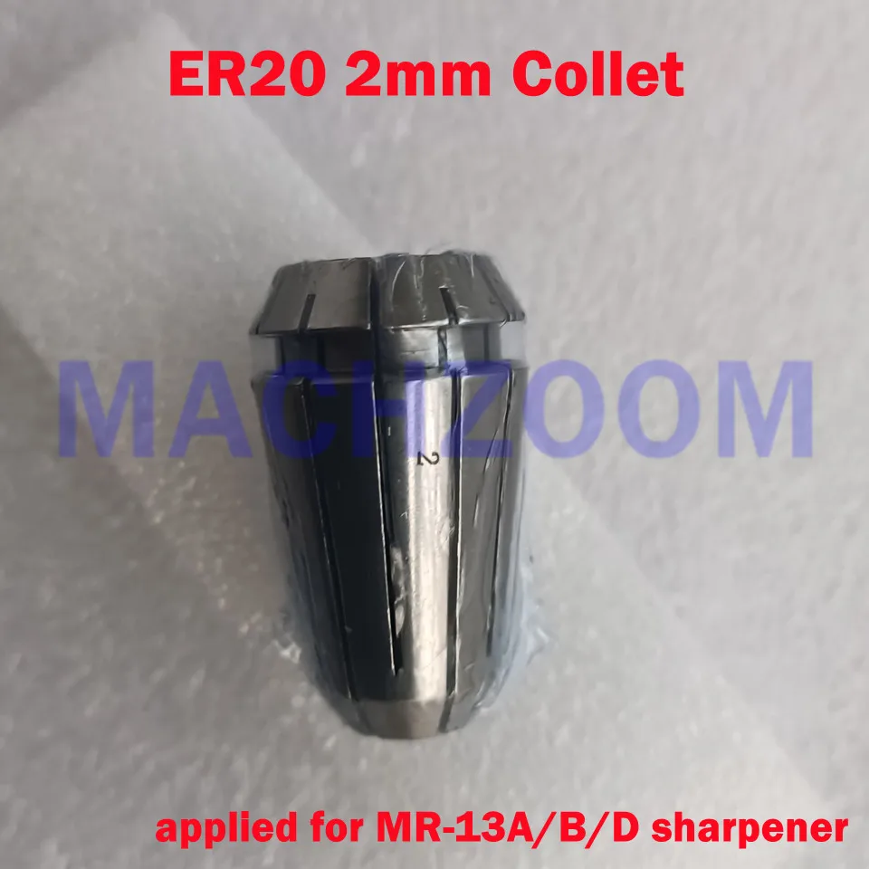

I ordered from Accusize a set of imperial ER20 collets 1/16"-1/2" (# 0223-0799). Yes, they are sized for imperial. The sizes 7/32" - 1/2" have their bores the same diameter the full length of the collet.
1/16" - 3/16" are countersunk at the rear, so those sizes will not work in these sharpeners.
I plan to order the metric half sizes as suggested to me by @Susquatch https://www.aliexpress.com/item/1005004442645715.html
The less we have to squeeze the collets to hold the drill bits, the easier it is to set it up in the collet chuck, and possibly get a more accurate grind.
