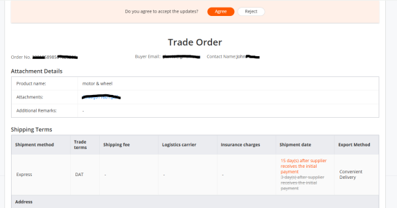

Okay so this is effing perturbing...
after I placed the order and paid the vendor modified the agreement. I can accept or reject the modification. They changed the fast shipping significantly and wont even ship the items for 15 days, and I dont know how long to arrive based on this.
Those people who agreed to order wheels/motors please advise what you think. I'll go with the majority. It's over $800 on my credit card waiting for these guys to deliver.
Edit:
I agreed after all after speaking to the rep again, and was told it was a thing with the alibaba platform. We shall see
