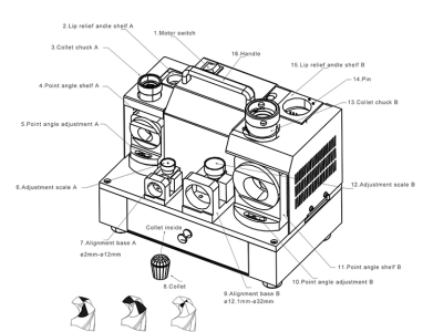

Now I have a dumb question. I had hoped Mr Pete's video would answer it, but no.
When setting the depth of cut for the collet/bit, you are supposed to turn the knob to the size, say 13mm. Referenced to what? mine does not have a stationary arrow or mark on the body at all.
None do. Just pointing to the frame behind it. It sets the width for the lip to register properly on its edge. It will never be perfect. But that doesn't stop the lip from registering properly. You know if it's right if it's parallel to the flats on the collet holder.
