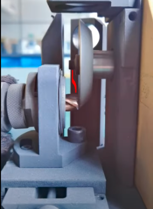

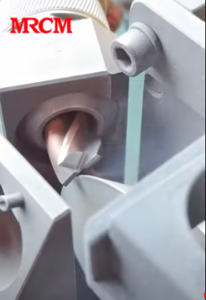

The grinds:
Front grinding fixture cuts the end cutting edge and the axial primary relief angle with the slight concave angle by positioning the end mill at a slight angle to the vertical flat face of the grinding wheel.
The A tool plate grinds the end gash and the axial rake angle of the cutting edge by positioning the end mill against both the front of the vertical flat face and rear bevel of the grinding wheel. I believe that the positioning pins in the top of the tool insert sets the gash angle while the tilt of the plate insert sets the axial rake angle.
One of two other grinding fixtures cut the secondary axial clearance angles. The choice of which fixture to use depends on the cutter diameter.

Hey, can you post a photo of a split point grind on your A model?

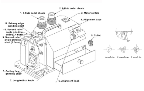

The manufacturer makes a bunch of machines mostly based on this design that sharpen end mills.
Recognize this machine.. two extra fixtures and a dovetail slide and voila it sharpens end mills
The reason I had asked was I thought I could see an issue in the plan. To sharpen a facet on an end mill you will need to use the flat side of the wheel or move the bit (or the wheel) in a linear motion across the across the primary relief to get a flat facet. (Each facet needs to be ground separately, The facets are not flat compared to each other.)

Sorry just catching up on this thread. Item 8 and 9 are the important parts of the end mill sharpener. They cut the flat primary facet and the secondary (relief) facet flat. It looks like they are using the flat side of the stone to do this. (A better approach would be if you can move the bit past the wheel or move the wheel past the bit. Kind of like how a surface grinder works.)
In this configuration it would be easier to sharpen a drill bit with a 4 facet grind.
This video might be useful. It is 14:52 long. Describes sharpening an endmill on a D bit grinder. I know not the same tool, but gives a good description on each part of the grind process, which can then be translated to how they do it on this MRCM machine.

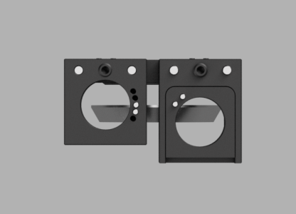

It would have been a better screw location @Susquatch , but I was trying to retain the same "insert" design to make it flexible for end mill grinding, and it did not leave enough material at that location. Here is the same parts without the insert
I may ditch that in favour of two swappable plates instead. It is just harder and more annoying to make the plates with an angled hole instead of angled insert.

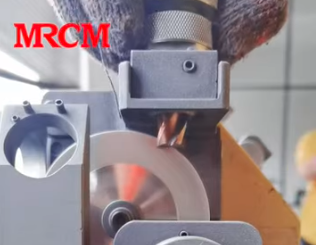

As far as I can tell from all the measurements and videos and photos the A model does the point splitting using the front edge of the wheel rather than the back edge. I wasn't able to get the wheel projection on the A machines yet though to find exact projection of the A tool plate compared to the wheel
I do have the solution though. I'll put an insert type tool holder in the A tool plate location... and the normal non-insert in the B tool plate location because that is how the insert tool plate is installed on the end mill sharpener. The projection is exactly the same, because the grinding wheel is reverse with the wide flange on the outside for end mill sharoening.

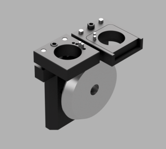

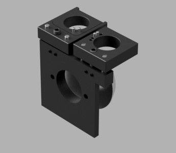

Okay this may be the final iteration before I make the parts. Independently adjustable on the Z axis.
Are you going to 3D print first or go right to steel?
I assume the wheel is flipped to use the rear socket. I am usually very good at seeing things in my mind. But I haven't been able to see this one. Any orientation my mind sees doesn't work. Can you (or someone) do a Fusion model to see how that works up close and personal?
If as Ian suggests there are no flats on the shaft, and we have to flip the wheel all the time, I would want to grind flats in the shaft, or maybe there is some other approach.
I assume this is necessitated by the need to provide an adjustable Z? Could that be facilitated without flipping the wheel by a pocket and various inserts instead of a slide and inserts? Or maybe an adjustable Z slide......
