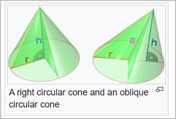

I freely confess that I did learn that some people call a helical grind a conical grind while admitting that its not really a cone (that's all very confusing to an engineer like me)
I'm not crazy about 'cone' either but that is due to my mental image bias. Just like 'lathe levelling', haha
OTOH, we need to be understanding of the Team Cone. Apparently it doesn't have to be the common flavor with circular base, apex projected perpendicular from the center like we would visualize a sharpened pencil. The base can be any kind of curve with apex at an angle & Team Cone has not defined the orientation. So it could be a cone.
A helical geometry can be visualized like a thread - a defined infeed increment per rotation. Some grinder cams work this way, maybe that's the basis of the Vevor? You can see this profile on single edge countersinks. Zero flute countersinks (with the hole) are a different animal I haven't quite figured out. I think they are like this profile sketch but they seem to vary. Anyways with a cam, it could be anything, not necessarily helical.
And then there are the radius or swing arm style or rocker style which are different again because the radius once defined is constant, just projected through the surface at some offset distance & angle
I both love and hate the way you think sometimes.
Team cone eh! I'm killing myself laughing at that! I think I prefer being "some kind of complete loon" as per the Quorn article.
Our helical or eccentric grind is still not the cone in your diagrams. Your second cone is really just a regular cone sitting at an angle on a base. Said differently, the base is a section of the cone that is at any angle to its axis. Viewed from anyplace on the axis itself, it's still a regular mathematically perfect cone.
Maybe we should try to develop a math formula to describe what you and I have been calling eccentric and helical grinds and then give it a more appropriate name.
Every time I hear the term standard conical grind or any of its varients, my hackles vibrate. Obviously, I'll never be a member of team cone. You would have to kill me first. But I am perfectly comfortable calling it an eccentric or helical grind. I could also live with something like precessing grind. I wonder if an engineer at a drill manufacturer has a term we could swipe?
How about eccentric helical grind? LMAO!

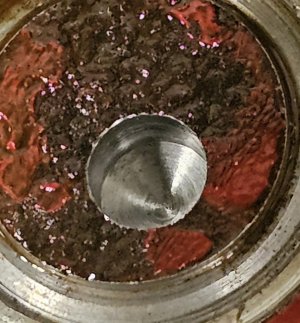

Has anybody sharpened a drill and drilled a hole with it yet?
:D
Yup. I did. It works perfectly.
Thinking of changing my user name to "TheLoonyEngineer".
See here for photos and proof that it works.
Yup. I did. It works perfectly. See here.
And the hole.....?

I think it is important to say a few things about cones. Cones are 3d shapes that have bases that are 'round' and rise to an apex.
A 'standard' cone, is the regular, right, circular cone (what comes in the kid's set of blocks). But a 3d shape can still be a cone if it looks like it came out of the wrong end of a dog. It still has a 'round' base and an apex, but you would never want to use that shape as a drill point on purpose.
I also think it is wrong to say that these shapes are helical. The tool path to create the desired shape is a helix. And probably a special kind of helix called a clothoidal helix where the 'slope' changes proportionately with the length along the path, but the resultant shape is still some kind of cone. If there is a precise name for that kind of shape, I don't know it
And then I think come the complex parts of the cut. I think your pictures show more about what a good shape is than anything I could say. And others have also added important information. But in this one area of nomenclature, I think I can help with why there is such confusion - even if i can't really help to dispel it

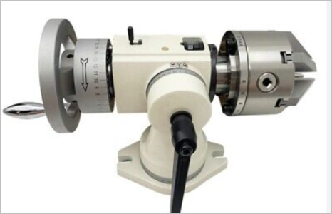

After all tbat, I am back to the same point (PNI) I keep making. This project is not about grinding a superior drill. It is about modifying an economical drill grinder to do both variable web thinning and spilt points without breaking the bank.
Perhaps once that is done, it might make some sense to look at what it would take to do 4 facet sharpening. But that is about the extent of what I am willing to do. For anything more than that, I'm back to buying better drills and either discarding or repurposing them when they get damaged or worn out.
