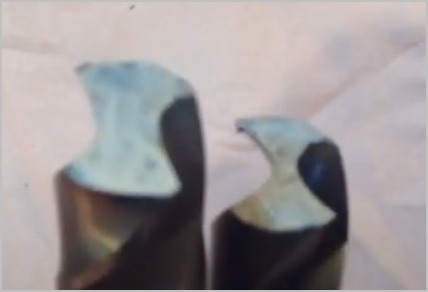

And just to throw this into the mix, turns out 'split point' is more of a generic term than I realized. There are different shades.

There was a good outcome from watching this video though. In my mind, I have been assigning Split Pointing into a subset of grinds that includes webthinning. But now I am forming the idea that split points are actually only one of many different kinds of web thinning grinds.

I should have provided my 'skip to time X:XX' so your eyeballs wouldn't melt LOL. I wasn't really interested in his opinion so much as I learned something new. The split point (left) or at least 'his' split point has a considerably larger center core, or shallower flute pockets however you want to define it compared to regular drill )right). That's done for rigidity & other reasons. But the implication is when you translate that thickness up to the tip, do the primary grind, you are going to have a much fatter dead zone core area. If left that way, undesirable. Which is WHY they split point. Now I took one of my so called split points & ground it straight like he did & it looks remarkably like my regular jobber. So he may be branding all split points the same when in fact they may vary among brands, materials & applications. I happen to know they do in fact vary, particularly carbide & carbide with cooling ports, but just trying to reframe why I mentioned this video at all.
2:52

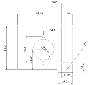

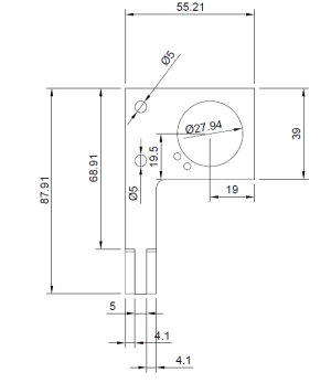

So I'd like to get a couple of owners of MR-13A machines to provide me with the following measurements to replace my bare azzed guesstimates with.
These is a rendering of the two parts in question.
The image below is a plan view of the two parts looking from the front of the machine.

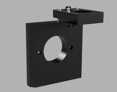

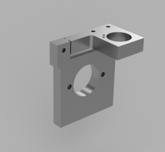

The image below is is from the back side of the vertical upright piece.

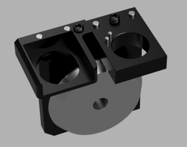

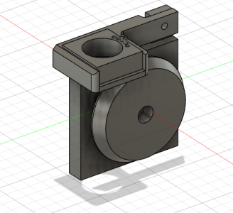

Okay, I've been looking at both the A and B model designs. It is clear to me that they designs are the way they are to make production as cheap as possible without the need for any complex machining operation.
The two machines I have measurements for have clear differences in the vertical plate thickness, and other areas, which I thought surprising. This piece is the main positional register for the shaft and grinding wheel. But that isn't really an issue.

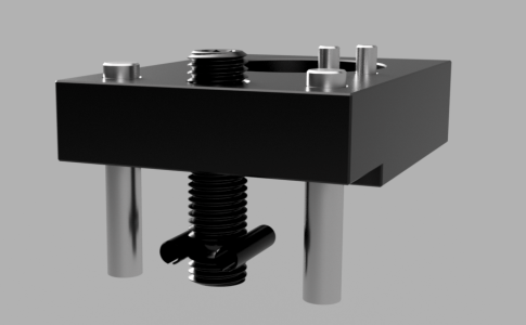

My goal is to make a very precise multifunctional tool grinder, not just for drill bits but also for end mills ends. By selecting pivots to raise and lower the tool holder in an arc there is no simple direct reading of the depth of adjustment.

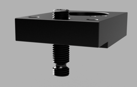

I propose to fix that by having each tool block adjust its vertical position by turning an 8mm grub screw. The screw will act as a jack to raise and lower the tool block, and two 6mm precision ground pins will serve to guide the block along the vertical plane without an rotation.
This method works by having the tool holder block threaded for the 8mm screw, while the vertical base plate has an 8mm clearance hole in which the screw sits and can revolve freely. In order to prevent the screw from being pulled from the base the end of the screw will have a 3mm retention groove machined around the circumference.
Meanwhile, the base will have two 3mm holes perpendicular to the screw and on the level of the 3mm groove in the screw. Two roll pins will be inserted into holes in the base, through the groove on either side of the screw, thus the screw will be prevented from retracting out of the base while still allowing the screw to be freely rotated.

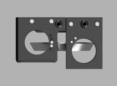

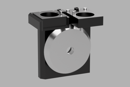

The two tool blocks can then move independently from each other with a vertical adjustability of upwards of 5mm of travel, or be removed entirely and substituted with a different block for a different purpose. For instance split point block A could be substituted with split point block B which is offset x degrees from vertical
The vertical upright plate dimensions I have are two different thicknesses... so I wonder if there is a slight difference in the base hole locations. I doubt it but wonder.
The difference I have infringes on the sheet metal case by 2mm which I wont modify, so I;ll have to see how critical these are... or I may change the design to use a vertical motor mount that based on the thinner dimension. That will mean I cant use the insert for the 13B restricting my options.
But at least I'm ready to print up some mock parts

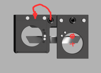

Two questios:
On the left side, would it be better to have the screw between the pins than off to the right? What drove that choice?
On the right side, why is the collet holder center so far away from the rear edge of the wheel? Help me understand the goal here.

Two questios:
It would have been a better screw location @Susquatch , but I was trying to retain the same "insert" design to make it flexible for end mill grinding, and it did not leave enough material at that location. Here is the same parts without the insert
I may ditch that in favour of two swappable plates instead. It is just harder and more annoying to make the plates with an angled hole instead of angled insert.
As far as I can tell from all the measurements and videos and photos the A model does the point splitting using the front edge of the wheel rather than the back edge. I wasn't able to get the wheel projection on the A machines yet though to find exact projection of the A tool plate compared to the wheel
I do have the solution though. I'll put an insert type tool holder in the A tool plate location... and the normal non-insert in the B tool plate location because that is how the insert tool plate is installed on the end mill sharpener. The projection is exactly the same, because the grinding wheel is reverse with the wide flange on the outside for end mill sharoening.
