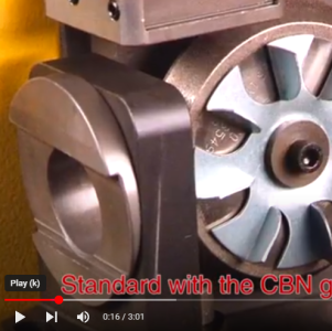

To grind milling cutters the tool seat is moved 90 degree to present the end mill to the face of the wheel at a 2 degree offset IIRC. The tool setter is different too.
Then the points are ground using a split point gauge that is angled to the top of the wheel. Only old style vevors had the ability to change the insert in the spilt point gauge.
Below is a dedicated end mill sharpener based on the same design. You can see blocks for what appears to be flute grinding and I believe relief grinding as well. Can easily make a stamped metal guard to cover the end but you could 3d print one. Interesting mods to be made to this machine...
Correction: The two gauges on the left hand side of the machine are the secondary relief angle cuts. The gauge closest to the body cuts secondary relief of 3/4 flute end mills, the one furthest away cuts secondary relief on 2 flute end mills. Flutes are cut using other side of the machine with different wheel and R8 collets to hold end mill.

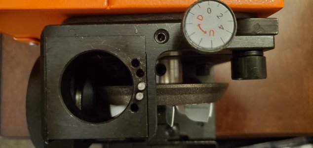

Can someone with a model 13A please take and post a photo like the one below.
You're phone needs to be level and coplanar with the top of the machine. the grinding wheel should be exposed and the shaft as visible as possible

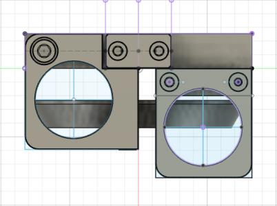

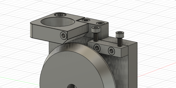

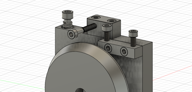

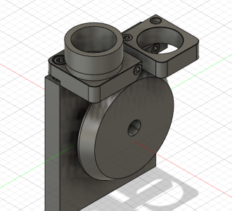

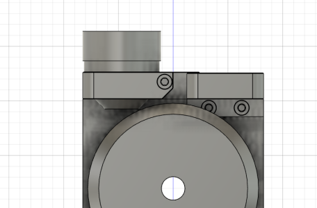

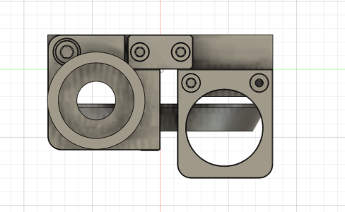

Making it a duo.
Replace main upright with newly milled block, or mill existing upright flat on top. Mill split point tool block mount, mill web thinning tool block pivot mount, mill both tool blocks. Assemble.

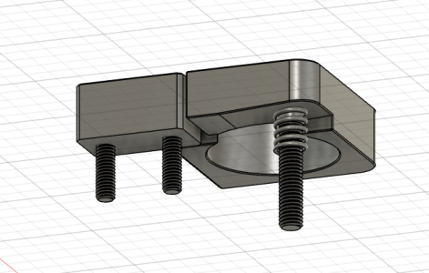

The rear of the we thinning tool block is relieved to allow depression from 90 degrees. The spring sits in a pocket on the main upright.
The hole in the tool block for the height adjuster is a slot.
I intend to 3D print parts for a prototype to test the positions of the tool block, then make actual parts after testing.
Edit: I haven't yet drawn in the collet chuck locator pin locations and pins.

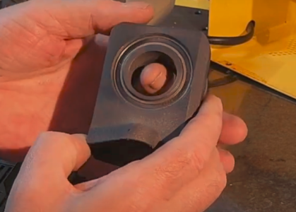

The collet chucks are concentric.
The grinding seat that the collet chuck sits in is canted at about a 5 degree angle from the vertical plane the seat sits, so in action I do believe that the drill bits do take an eccentric path as the bit is rotated.
So @Susquatch it seems none of those cliquey 13A boys want to help us out with an accurate photo so I can check the dimensions to assure the proper alignment of the tool blocks.
I think they're pretty good right now, but I want to be more certain before I crank up the 3D printer.
In addition to the grinding seat fixture being canted about 5 degrees off of vertical, I've found that the rotation is also offset and as you can see from the screen cap the bore is eccentric to the bearing in which the ER collet chuck rotates as well.
