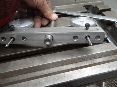

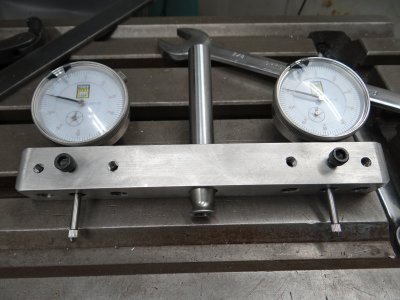

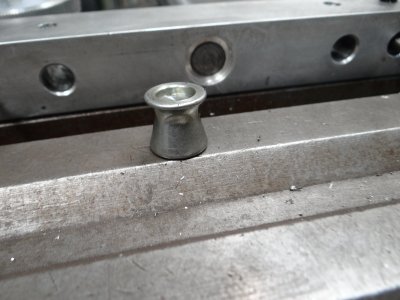

I made my own a few years ago, after using a new 12" brake disk for tramming the head long enough that I was sick of it. The spindle square tram produced the same result and did it much easier. I use a small round magnet about 3/4" long for zeroing the indicator, and it stays stuck to the t-bar. I would not do without one again.....but since my friend gave me his shop when he died, I now have 2 of them.
It is un-necessary to have the worlds most expensive dial indicator, because once zeroed, all you are looking for is deflection, and adjusting to get no deflection of the needle.

Picture please

Picture please
Here it is. You take the magnet off and put it on the table, and then zero both dial indicators to the top of the magnet. Remove the magnet from the pathway and then rotate and check your readings on the table in the X&Y. The bar can sweep a 10" circle at its outside hole position
