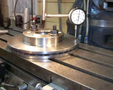

A question for all regarding spindle squares.
The tables on all 4 of my mills & drills are not perfect. And even if they were, the TSlots make calibrating a gauge or indicator difficult. I have always swung / swept the indicator tip backward to avoid damaging it.
But all this discussion about tramming has me wondering about what I will call a tram plate. Something like a precision ground plate that you set on the bed and then run your indicator (or tram tool once I make one) on that.
I'm thinking that perhaps a premium automotive brake rotor might be a great solution. They are typically ground to be ultra flat when new and they are not outrageously expensive for what you get.
However, I find myself wondering how well they would work on a mill table. How much would an oil film or a human hair or the one teeny tiny ding my stone didn't catch affect its usefulness?
Anyone have any experience or thoughts on this?

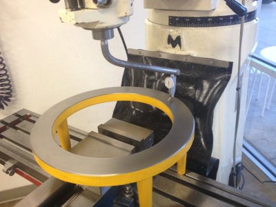

Hey @RobinHood, @PeterT, & @Brent H , & all those others following this thread. I had to go visit the doctor today and had some time to kill waiting for my turn in the torture room.....
I decided to spend some time looking to see if anyone had ever made a 3 gauge tram system. I didn't find one, but I did find these interesting ways of going about using two dials.
One is actually the brake rotor that I thought might work. Apparently someone else had the same idea. And it does work!
The other is a raised rotor that clears the vice. I really like that too! No need to remove the vise to tram the mill!
I'm thinking that maybe three custom precision blocks under the rotor would work just fine.

Jeeez you could make that raised rotor gizmo yourself. "hey SWMBO, i need to buy a surface grinder" Guess what the answer will be, NO, HELL NO.:(

Found two old car brake rotors in my scrap metal pile this morning. Just for Sh**s & Giggles, I put one in the lathe and checked the runout. Not good as is. Cleaned off the rust on the hub section until bare metal showed and tried it again. Woah, within 8 tenths. And it's a very consistent wobble so even that can be taken out with a few mallet raps.
With the hub up, it even clears my vise sitting on some 123 blocks. With a little more cleanup, I think we have a winner!
Just need some 1/2" plate to make that goofy gnarly looking 3 gauge illusion I have in mind and we are in business!

It's unlikely that you can machine a used brake Rotor to be better than it is without a surface grinder. The brake pads themselves are pretty good at making a flat surface. I'd just find a good one and be done with it.

Resurrecting this older thread.....
1) The tram on my mill is not perfect. Correcting it is one of the many things on my to-do list. Please correct me if I'm wrong if using the swept single indicator mounted in the spindle method, if the fixture is not perfect (perfectly parallel to the spindle) it doesn't matter because that error is the same regardless of the swept position, and hence cancels out?
2) Anyone measure a NEW brake rotor, how flat are they? According to Google they are supposed to be within 0.002" but most people measure more ( like 0.005"). That does not seem nearly flat enough for a good tram. I'm also thinking the torque applied when bolting the rotor to the table could cause deflection in the same range, thoughts?
3) How close do you need to get the tram, so that multiple parallel passes with say a 3" face mill will not leave a visual error on the freshly milled surface?
I measured mine before I used it. As I recall, it was only out a few tenths. Google is probably talking about used rotors or junky quality. A new high quality rotor should be pretty darn good. Otherwise they would throb during braking.
Why would you torque it down? I just set mine on top of three matched 1 2 3 blocks.
