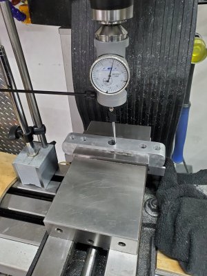

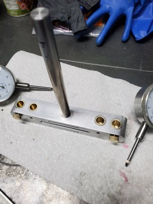

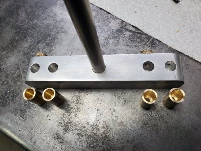

Don't want to derail the good discussion going on but just a small update on fixing a "problem" on my spindle square that shouldn't have happened.
The stem (not the moving part) of the indicators measures .375" so when I made my holes for mounting I thought "well I'll just use a 3/8" drill bit because that will also give me some clearance as a drill bit usually drills oversize somewhat". The holes ended up being sloppy loose and I hated how the indicators bobbled around until I tightened up the screw. Ya it probably didn't matter much to the operation but it bugged me, so I bored out new holes and made brass inserts with a REAMED hole that fits perfectly now. I got to try out my new coaxial indicator for re-entering on the shaft hole. Yes too much "work/time" for the project but I enjoyed it all. My shop time makes me a better man.
The stem (not the moving part) of the indicators measures .375" so when I made my holes for mounting I thought "well I'll just use a 3/8" drill bit because that will also give me some clearance as a drill bit usually drills oversize somewhat". The holes ended up being sloppy loose and I hated how the indicators bobbled around until I tightened up the screw. Ya it probably didn't matter much to the operation but it bugged me, so I bored out new holes and made brass inserts with a REAMED hole that fits perfectly now. I got to try out my new coaxial indicator for re-entering on the shaft hole. Yes too much "work/time" for the project but I enjoyed it all. My shop time makes me a better man. View attachment 18316View attachment 18315View attachment 18314
She is beautiful @DPittman!
No worries, I think it was my fault that this original thread took a left turn. But it is at least on topic.
I'll be making something like yours soon enough!

DPittman that looks great with those brass inserts. I will have to contemplate making one.
I dare say that @DPittman's gauge actually looks BETTER than it would have looked if the original holes had been a perfect fit! Best of all, the indicators won't get scratched!!! I love it!
Many an advance made is the result of a mistake that really wasn't......
Well done @DPittman !

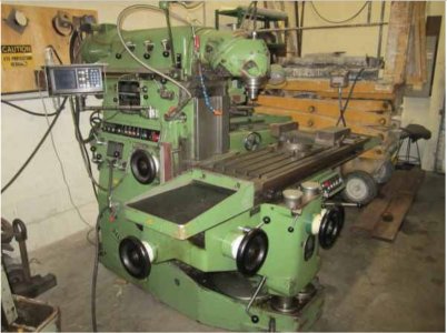

Speaking of milling heads that are difficult to tram: the Huron style ones are apparently the worst because it is hard (impossible?) to isolate the X and Y directions from one another because of the oblique mounting flange. This is where a calibrated tramming tool shines.
