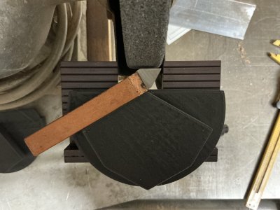

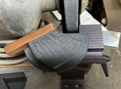

I made a similar slide plate for my TCG but its a bit of a rigmarole to set up the compound angles. I wanted to see what I could get away with with 3DP assembly & my bench grinder. The drill is held in a 5C collet block, advance into the wheel along fence up to the finger stop. Flip 180-deg & repeat. This ensure left = right. Increment infeed the fence with the mini lead screw. I was quite shocked, actually not too shabby geometry wise. Its the wrong wheel for the job & the grind striations look worse than in real life because I blackened the drill with felt marker & stroked the facet with a stone in an attempt to photo the dual angle. Yes I know, my facets don't quite meet up perfect because the whole setup is just tacked in place. The big issue I already knew from the TCG is few of these hardware store grade 'practice' drills are very coaxial or equal flute. Well, not exactly machine shop quality but it was a fun little project.
More details please! What is holding down the collet block? And how does that lead screw work inside? Maybe some section views?

The collet block is not held down. You gently push it inward to the fence for contact & slide it down until it grinds a bit off & reaches the foot stop. It is admittedly primitive but this allows you to flip the block & grind the other side to the exact same compound angle repeat
For each grind increment I loosen the lock knob (residing in the slot) & advance the 'leadscrew' knob. It is acting on an embedded hex nut glued into the end. Not in model but I have a spring in between the end of the green fence & the blue swivel table.
The fence runs in a dovetail which actually runs pretty smooth with just minor cosmetic sanding to get the fit.
All the knobs are identical, just use M4 threaded rod to various length
This is the cheesy angle adjuster stop (and is actually needed to support the weight of steel collet block). It has a dome top because the swivel plate above it contacts it tangentially. The idea was to grind a facet, say the primary (both sides of course doing the flip-flop), then screw this adjuster down & grind the secondary with drill/collet remaining in exact same position. This makes a straight band facet. But because of the table swiveling geometry, now the extended drill is a different distance to the wheel. So you adjust the fence stop down the dovetail so the drill end just kisses the wheel & infeed from there. Its this last secondary facet which is pushing the limits of a rather dubious 3DP contraption. Because the facet might only be a 0.010-0.015" wide band depending on the drill size.

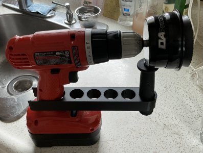

I bought a drill attachment to allow some polishing whatevers. To use you are to hold the drill and the handle with the other hand. Ok, let make it better. Printed a link bar to hold the attachment handle stationary to the drill. Works fine for me. Just have to trim the ears of the slot at the drill end.
