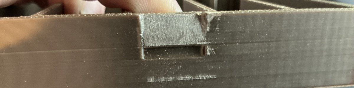

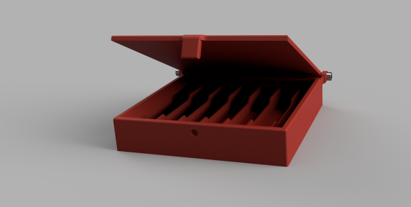

I did file the lead in ramp to get a smoother action.

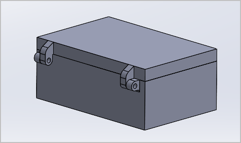

Actually there really is no reason not to make a ramp on both sides, just mirror it. Then it wouldn't matter which way the lid went on. The thicker clasp on the lid is the only unique feature. I might make the thumbnail part a bit bigger. I was also thinking of something more like a circular groove on the inside corner to act like a flexure vs the sharp 90-deg corner. Details, details...
@Janger I tried this kind of hinge. I tried SHCS too a better option was mini dowel pins from Ali which are spit cheap. Just push them in the holes & a drop of CA on one end to keep it in.

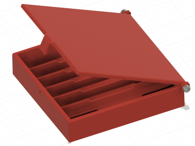

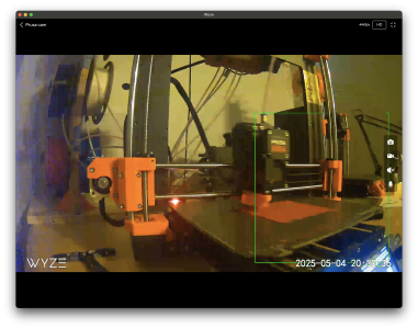

Details details... yes. I was inspired to give it a go. Trying for a hinged lid. No idea of those ears for the screws will work or just bust.
printing now in red. about an hour for the lid and 90 minutes for the box.

Fusion rendered image. I wish I could print this perfectly. This is with the rough powder coat appearance.

I like my stuff to fit without wasted spaces between things. Consider moving those hinges inside the box. A cone head screw could be mounted flat to the outside of the case. Put all your reinforcements inside so the only wasted space is for the hinge itself. A 3D printer should make that easy to do.
Inside hinges allow for boxes that can cuddle together without all that wasted space between them and behind them. An inside hinge also makes a propped lid (opens to say 120° or so) much easier to do.

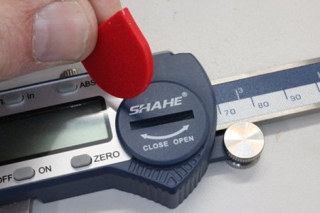

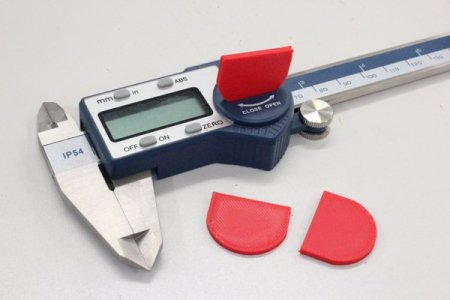

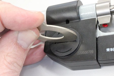

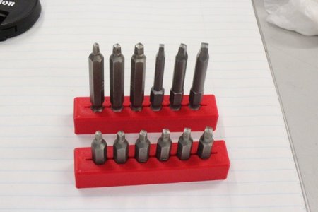

You know those instrument battery covers with the slot? Yes, the slot made to no particular standardized width, each one is a bit different. Maybe they are based on Asian coins because Canuck coins aren't much better fit than stamped metal ones assuming one was included. I just 3DP'd as set in various incremental thicknesses. Hint, don't use a blade screwdriver, they are guaranteed to mangle the soft plastic.
This is an example of something I've been doing more as of late. When you want to fit something with some degree of snugness but the printer tolerance and/or part tolerance can vary a bit so it becomes a trial & error repetition. Sometimes its easier to make the cavity match the actual part dimension, but add some kind of flexure slot so there is some give in the surrounding material.
