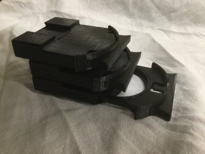

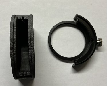

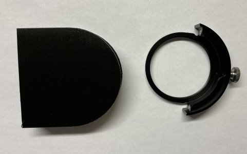

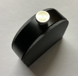

Here are some pics. Took me about 10 minutes to design in tinkercad. Printer all of them in about 13hrs with 35,,%, infill. Cheap white pla. Not sure the strength. Maybe better to print in petg.
Astro-photography tool. A filter slide that ZWO/Svbony sell without a storage case. 2” filters are commonly used in this hobby and they are not cheap! Have to protect them against scratches and dirty fingers. Similar to the filter slides I print for Canon/Meike drop in filter adapters, shown in the last photo.
