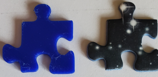

It does get easier. A friend and his disabled son just finished a 5000 piece puzzle that took them a year. At the end they found they were missing one piece. A different piece did fit so it was possible to scan a piece rather than photograph the empty spot. A bit of CAD and 3D printing...
I'll take it over there tomorrow to see how well it fits.
Just got a reply from my friend. Here's a small bit of the puzzle. Look for the bright blue. Apparently fits perfectly.
Feels good to use this technology and do something nice.
Excellent! The colour is off a bit but easy to fix if they even want to.
Nicely done!
Thanks. Yes. His son paints figurines so I thought they were going in that direction but he told me he may just try photographing a blue piece and printing it and gluing it on the piece. He's quite an accomplished photographer and even has a photo book published of pictures of old barns. He and his wife visited all 49 states and 10 provinces on an extended holiday. Only two states could he not find barns.
I said if he needs the piece thinner due to thick photo paper it's easy enough to print a thinner one.
