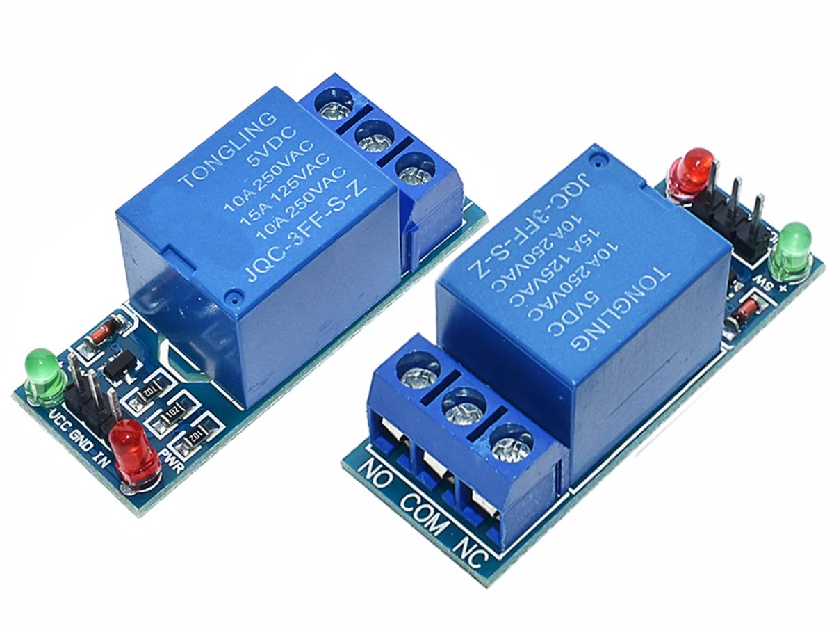

My last little build was for a small single pole relay to be used with my current lathe arduino project. 2 relays fit in, then 3 holes for wiring, only used one. Recessed lid and #4 x 3/8 wood screws.
The relays I use, universal is my go to for arduino stuff. Volker is great to deal with and he is in the GTA, so no boarder issues. He helped me with some programming a couple years back with one of their canaduino boards.
