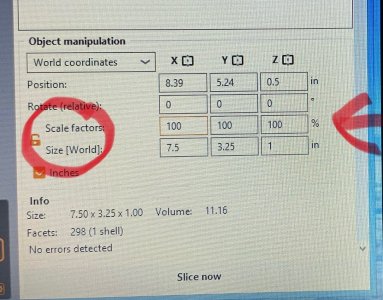

Here is a summary of the Ryan’s boxes I printed. I did print multiple copies of all of these. One can see that they are of different sizes as needed to fit the wild section of taps in my poor collection. Trays like this are very flexible in being able to resize. I included a screen shot of the area on the main screen of Prusaslicer. One unlocks the Scale Factors and you can either the percentages in X,Y, and Z or directly type in the dimensions you want in the respective boxes. I imagine that the other slicer programs have the equivalent controls.

I think this is designed for 12mm slots. In the slicer I just printed a 1/2" of it so I could see the width. Came out as 11.83mm wide. I then scaled the width to whatever percentage gave me my slot width. In my case, 19% gave me 14mm width. And I scaled the length to suit.
