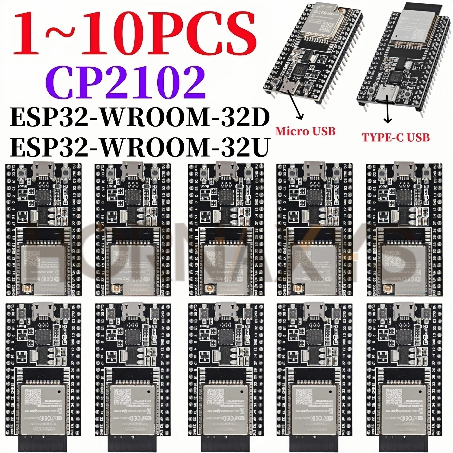

Also, you need to order ESP32-DevKitC core board ESP32 development board ESP32-WROOM-32D. It has to be the exact part. There are lots of these boards out there, and the pinout are different. They re available on Amazon or Ailespress. (https://vi.aliexpress.com/item/1005...st_main.5.7de11802a0ILgT&gatewayAdapt=glo2vnm).

They both appear from the specs to be the standard dev board, the C only denotes that it has a usb c port rather than a micro usb port

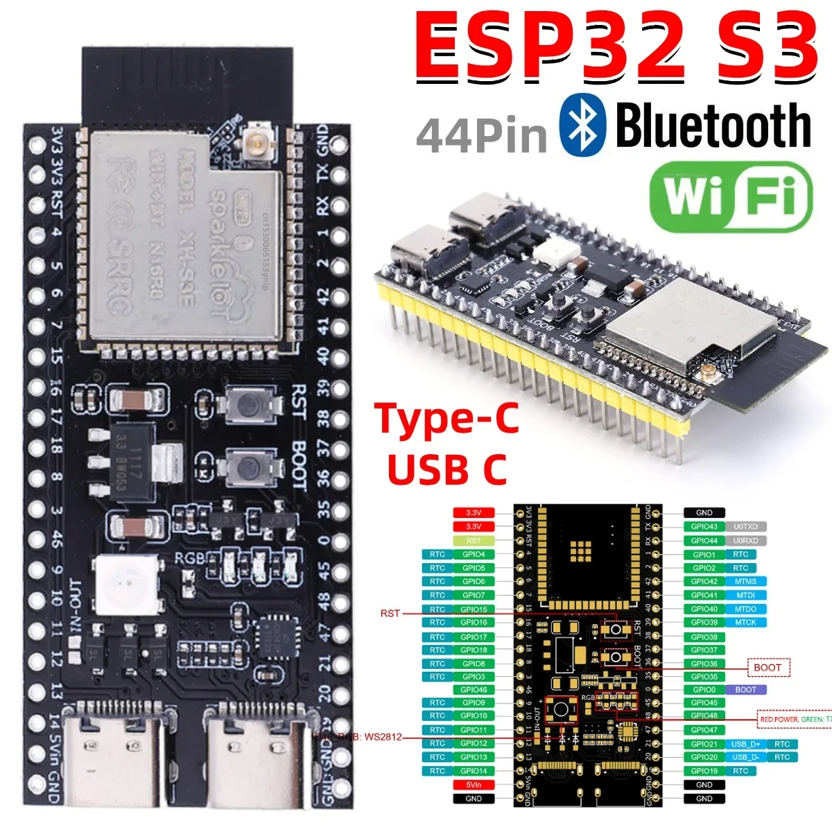

You gotta be careful. There are many different versions of these boards, and the pin-outs and physical size vary depending on who is making them.
The ESP 32C dev kit has a different pinout than the ESP 32U dev kit. They are NOT interchangeable. The type of USB port used is just one of the design decisions that the manufacturers make. Most are going to USB C as they come down in price. My ESP32C devkit had a micro USB port. It was still a ESP32C dev kit
You need to get the exact dev board @slow-poke calls for, or one that has the exact same pin out and physical size, or the board he designed will not function as intended.

To be clear I have not recommended any particular board. Tom sent me an ESP board so I could test the two boards I soldered for him, so I know for certain that board works (no idea where he sourced it), I then ordered an ESP board from Amazon that had the same pinout, however when it arrived the DIP spacing was 0.1" narrower. So when I tweaked the board R0->R1, I put another row of pads in parallel with the originals, just spaced 0.1" closer, to accommodate the narrower flavour of the ESP board.
When I went looking for ESP boards, many had different pinouts, and those obviously won't work. So if your ordering I would make sure the pin arrangement matches Tom's

There are some ways around the different esp32 boards but they can get messy. I have used 24awg wire and wired pin to pin to make a board fit. It’s not pretty but does work, the hardest part really is programming the esp32 the rest is just soldering wires.
