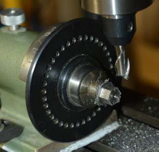

I keep forgetting that with the new grinding fixtures I recently bought I have another way to easily and quickly put flats on bar stock... albeit not as quickly as a mill can.
So I'll just skim pass all my milled flats to give them a smooth finish on a set up like Adam has here:
It Works! The trick is to use the same pattern each time. My first try wasn't bad but I was never going to find a wrench to fit a seven sided head LOL. I was laughing hard enough that I had to sit down for a minute.
Here is a shot of try number two using just the six side and not the six&eight sides at the same time, much better.

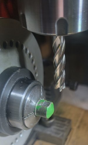

I wouldn't mind trying it although to be truthful any hex heads I've made have been with the 5C collet spin indexer. At the moment I can't think of anything I'm making that needs a hex head.
I am the same. I just finished putting a hex head onto some fuel injector caps for my tractor. No way a rose index would have handled that. The caps are only a half inch long and are barely held by a collet in my spin Indexer.

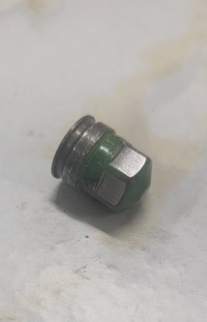

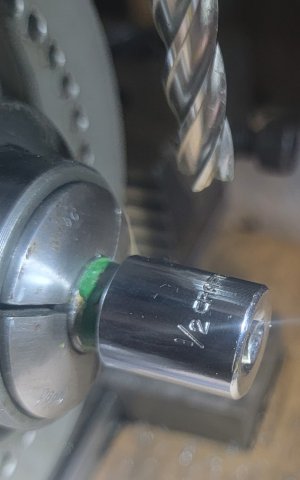

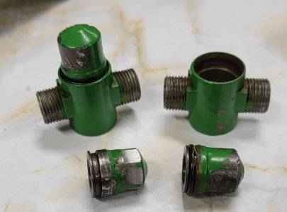

Since the forum was down, I took some time to modify another injector.

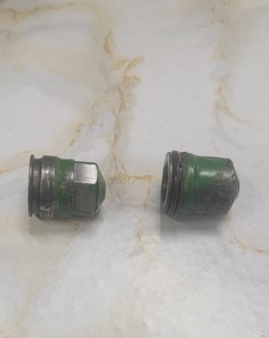

Here is the original and my modified cap to take a 1/2" socket. The cap screws onto the top of the injector return line manifold.
20230106_180953.jpgThe dealer uses a special pliers. I couldn't get that to work well at all. My hands are simply too big. I ended up using vise grips. You can see the marks on the cap. Yuk.

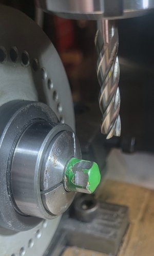

Basically, I clamped my spin indexer in my vise, then set my quill height using a half inch rod and 1thou paper, then dropped the quill 3 thou (1 for the paper and two so the nut will fit into a socket), then put the cap into a slightly bigger collet to fit, then cut a flat every 60 degrees.
Easy peasy. Here are some photos.
View attachment 29236The dealer uses a special pliers. I couldn't get that to work well at all. My hands are simply too big. I ended up using vise grips. You can see the marks on the cap. Yuk.

Looks good. One thing that is not clear to me....is that part you put a hex on just a cap? Is it solid? It doesn't appear to be threaded in? Just oring seal? And if so why would a feature that allows it to be turned be helpful....don't you need more pulling force than twisting?
It is actually a nut. It has an internal thread that fits the top of the threaded injector body. As it is tightened, it pulls the manifold down onto the injector.
I have no idea why it didn't have socket flats from the git-go. Perhaps to stop folks from over-tightening?
Oh I see, how utterly stupid of the designers to make it that way. Torque specifications would have been an intelligent way to address concerns of over tightening. Good fix on your part!
I'm pretty chuffed with the improvement. But a small part of me thinks I am overlooking something important.....
Anyway, you can only imagine how hard it is to tighten a round nut when it is buried behind a whole mess of other parts and sits on an angle that is very hard to grab.
