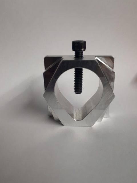

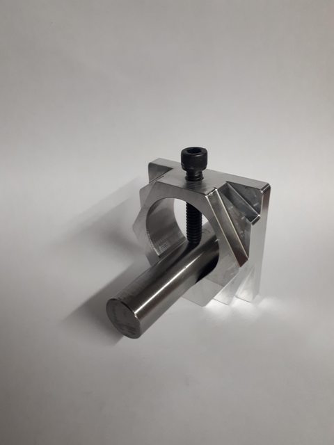

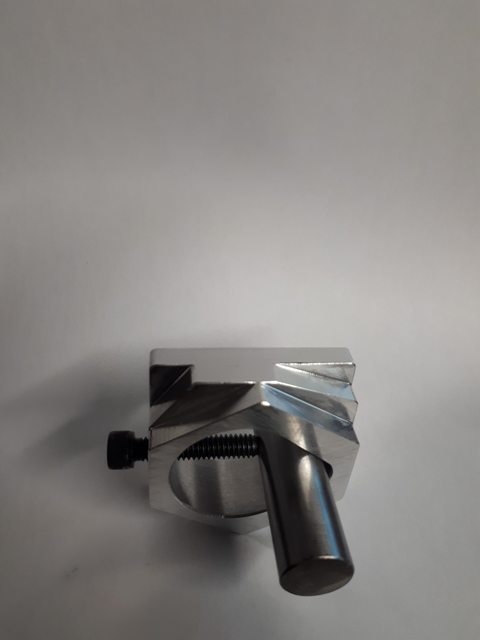

Here's my quick and dirty morning break project.
4, 5, 6 sided index. Will hold from 3/8" up to 1.25". I drew it up quick last night, and had planned on making 2 (one for work, one for home) but while cutting it, thought of a few improvements so I only made 1 for now, and will make some changes to the next ones. It's 2"sqx0.75" thick, with a 1/4"-20 screw. Each step is 0.25". Shown with a 5/8" pin.
I'll throw it in the tumbler tonight, and send it out for anodizing in our next batch of stuff for work.
Sorry for piling on your thread Janger, but thanks for kicking my butt in gear. Might not see a lot of use, as I use my er32 collet blocks a lot for small stuff, but ya never know. Could come in handy some day.

Nice work fellas, I was thinking I should try making one of those a while back but then these came up and for the price (when they are on sale) and figured it was too easy not to try them.

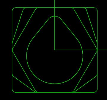

Amazing how our eyes deceive us too. I'd swear from the photos that the sides on the hex part are not the same length.
Looking forward to the improvements.
Good eye, they are not equal (it IS symmetrical from side to side though). Same with the Pentagon. They are simply run out to join and blend into the outside flat sides. They don't need to be equal due to the way the tool is used, it really doesn't matter, only the angles do. It would also just create a bunch of unnecessary extra work to deburr :D. Plus I wanted one shared flat surface where the screw came through, and to make all shapes concentric with the center they wouldn't nest together in a nice aesthetically pleasing (to me anyway) homogenized and compact product like that.

Looking at it again now, I could push the penta sides around a bit to further achieve that goal, and make the indexing flats a bit larger. I'll do it on the next ones. I seriously doubt I'll ever even use the penta side though, but it was kind of an afterthought, when I thought I could fit another set of angles in there. How many times would you need to rough index by 5? Maybe some top secret work for the US gooberment?
It makes for a better sounding name though. Like the 123 block, and the 345 triangle, this is the 456 index block. :D.
Some improvements would be the center hole angled faces being 60* (they're currently 77.57*). I simply just joined the 2 circles tangentially and didn't pay any mind to the actual angle because I hadn't concieved of holding hex stock with it, and it didn't really matter. Not that I probably ever would, but why exclude it? Would be fun to drill 5 indexed holes radially around hex stock. Might break the universe or something :D.

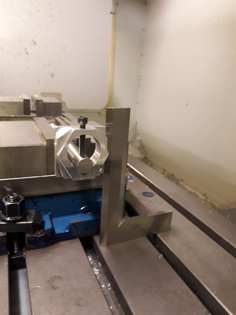

To be truthful I really can't get my head around how the hex sides which aren't at 60 degrees can then be used to mill a hex head on the end of a shaft. Especially since a larger diameter part moves it's centerline away from the anchor screw.
Maybe I'm not understanding how it's used in the mill. Those photos had so much other stuff in the way that it wasn't clear. To me anyway.
Maybe post an STL file and I'll 3D print a sample to get that hands on feeling.
I had wondered if everything needed to be symmetrical with all the sides the same length. So only the angles matter eh?
Sorry for the cluttered photos, I'll do better.

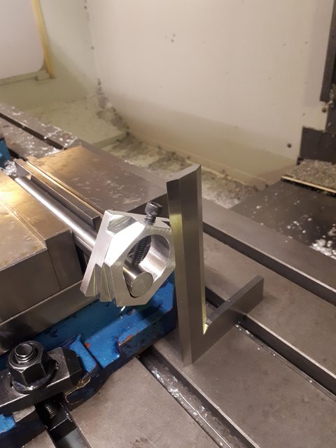

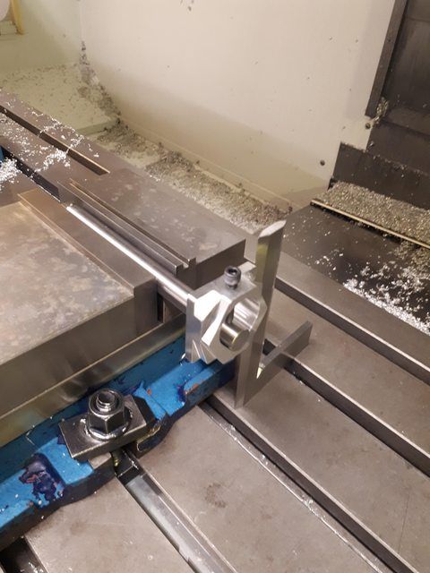

The part/shaft is held in the vise. Centerline/setup is taken from that. The index ring is simply used to index it's rotation by using a square against the machine table. It's concentricity to the shaft does not matter, just the relative angles. Hopefully these picture help show that a bit better. The ring isn't used to HOLD a part like a collet block. A vise is provides the holding power, this just simply indexes. I also wouldn't trust it for high accuracy, but I can see how this would be handy, quick and easy for a lot of things that have looser tolerance requirements.
As you can see, the shafts location never changes in relation to the machine setup, ONLY it's axial rotation in relation to itself.

Another benefit is the ability to take it off to do the machining, put it back on and square it up to the table before removing the part, then re-indexing the part and removing it to machine another feature. On some parts there really isn't a good way to hold them in traditional indexing fixtures.

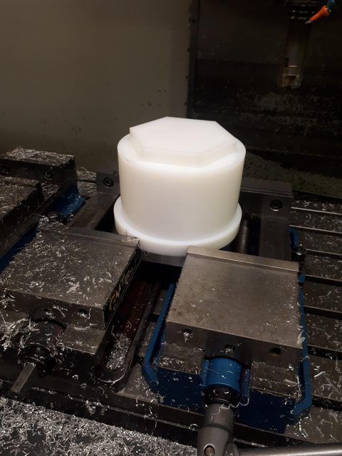

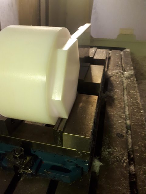

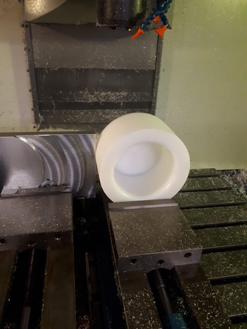

I actually machine indexing features into waste stock sometimes, like on this big uhmw block from last week. I had no other good way to hold this to put in the 12 mounting holes I needed to radially.
