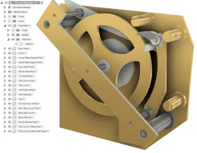

Dial mechanism for a Synchronome Clock. Ready to make dwgs for machining. the holes in Front Plate will get spot drilled on the CNC. All components sketched in place in 1 assembly. Free version of Fusion360.

I actually started this model with the Front Plate as everything mounts to that. then using my fav method of doing Powerpoint, I created empty componets for everything needed for the assembly (at least those I want to model). I then worked on a component, using S/Project to get the hole locations and modeled from there. Moving locations this shifted everything else due to In Place joints.
I seldom re-use parts but I do see how splitting those out would be a wise thing

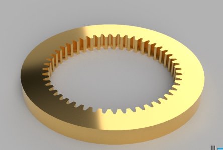

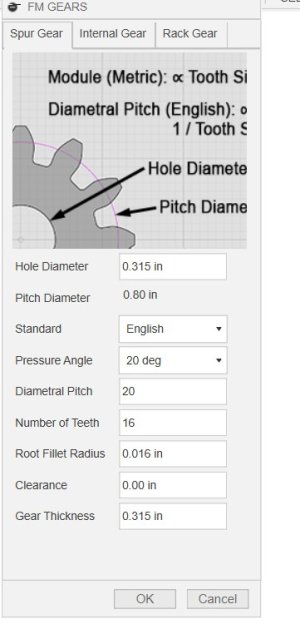

One of the really nice things about Fusion 360 is modeling gears. Time to model this gear was less than 1 minute. There is an add on module that makes it easy. It's called FM gears. An engine I'm interested in requires 2 of these. $250 USD each last time I checked. These might be a good candidate to use the CNC mill to make. Even if it's slow it would be well worth it.
I looked into this in quite a bit of detail when I (eventually purchased) an internal ring gear for my model radial engine. When you get into the math, there are a lot of factors that go into tooth design as a function of module & pitch - varying clearances, compensations, fillets & radii. These factors are somewhat unique to internal gears. The bottom line is some of these CAD profile generators vary in how much detail they go into it (ranging from borderline bogus to pretty good). This may not matter depending on your application, but something to inquire about because IMO for typical mechanical devices you might be in the range where it does matter.
BTW if you are looking at metric gears, this is a good supplier. USA distributer of German components. You might find, depending on size, they aren't nearly as expensive vs N-Am suppliers.

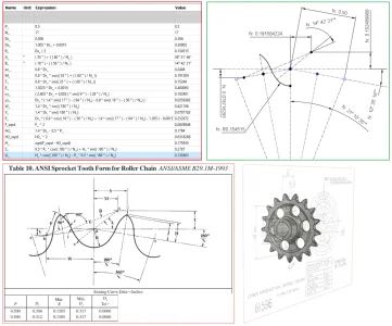

Or you can model the gears yourself using the formulas in a textbook for gear profiles. But this approach is really only feasible if the number of gear teeth required does not vary.
This is the sprocket I modelled, including the formulas (the formula’s came from Machineries Handbook):
Well that would be disappointing if the generated models are not accurate. I have not heard that mentioned before though. I would be ok with making one then trying it. If it is obviously binding or something I'm only out a piece of scrap brass.
That looks like more than I want to get into. Here is what you have to fill in when using FM Gears. A module in Fusion 360.FM Gears.jpg
