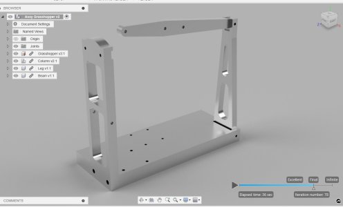

Playing around with Fusion 360
I don’t put bolts into the parts I model, just the holes.
My next experiment with “large” Fusion assemblies will be to export them as a STL or STEP and then see if that makes it easier to use them without bogging my computer down.
Above is about as complicated as I can go before my computer craps out…

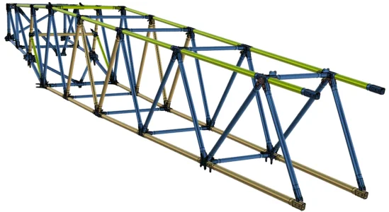

What is this?

What is this?
It’s the fuselage frame for a Hawker Hurricane. Super fun translating drawings into a 3D object:

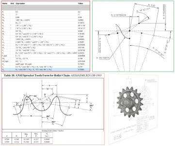

(Above is a pulley for the control column that a friend asked me to model so he could get one CNC machined. I used the gear profile from Machineries Handbook, making a guess that this was the profile the original pulley used. The original Hawker Aircraft drawing is behind the model bottom right)
(I should point out that when I did this, there were some bugs in Fusions formula, hence the cumbersome way I’ve structured them to make Fusion happy)
I'm not quite sure what STL STEP think would do to resources, size or speed/processing wise of modelling.
On the model in my post #61, the main issue I’d come across is that the models became “unstable” once their complexity got to this level (That is, they would start to repeatably crash so I couldn’t progress with inserting components much further). My hope is that by converting the model to STL or STEP that the unstableness will be delayed.
I haven’t experimented much with it since I was giving myself carpal tunnel due to using computers most of the day and then modelling in-front of the TV at night (I.E. when my wife was watching something that I wasn’t interested in…). Once I’m retired I’ll likely take it up again.
How much RAM is in your machine? Is that the problem?
16Gb. I’d run Windows 10 resource monitor at the same time to keep an eye on how much RAM was being used and it always hovered around 8Gb. So I didn’t bother increasing the size of my flock (my Mum would always say how her computer was getting slow and she needed more ram’s…LOL)
My laptop is getting a bit old now, maybe 5-7 years, so if I take up complicated modelling in Fusion again I’ll likely be replacing it.
Interesting. I'm an aircraft mechanic and had no idea the fuselage on a Hurricane was a bolted structure. I always thought they were welded.

When I was using solidworks I modeled the Piper PA-18 fuselage. I found solidworks to be way easier than Fusion 360 for welded assemblies. Possible that fusion has made it easier with updates though.
I have one source that claims Hawkers used bolted joints in the Hurricane (and later Typhoon and Tempest) because that’s what they were setup to produce. That makes much more sense to me than the often stated claim that bolted joints made the Hurricane easier to repair. Many of the joints have tubular rivets which would effectively eliminate being able to unbolt one strut and bolt another in.
When it happens again, combine again and so forth.
I’ve tried most permutations (as far as I can remember). Several large components with the same underlying geometry (wireframe). There doesn’t seem to be much difference to stability.
I’m wondering if it’s a graphics card problem, sometimes fusion opens using the onboard graphics rather than the separate graphics card.

Been getting back into learning how to do assemblies. I found it clunky before but I'm getting better at it. I had to refresh my memory on how to do it. I used to bring in parts and then align them with the first screen they were imported in. Terrible way to do it. Just bring them in then roughly align them. Then under modify use the align tool. It works pretty good. After that use a joint to set a position and set up any movement if required.

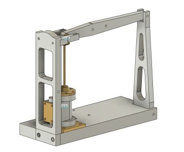

Going back to my CAD roots a bit by using one of Elmer's steam engine plans as a learning aid. This one is the Grasshopper.

A few more parts added in. I'm finding it easier to set up joints and motion but it sometimes requires some thought to make the motion work correctly. I am now starting to see why a space mouse would be useful. I now spend a lot of time moving the model around to select points during assembly.
Not sure if F360 has this feature, but maybe its possible to set up tiled viewports to whatever are good vantage points. If it works like other programs, you can start clicking or drawing in one window & seamlessly carry on into the other. Often this can be a preferred way to work at different scales or perspective, especially physically bigger assemblies. Zooming & scrolling & space-mousing have their place for sure, but it grows old when you have to do a lot of driving around the model, especially repeatable operations.
