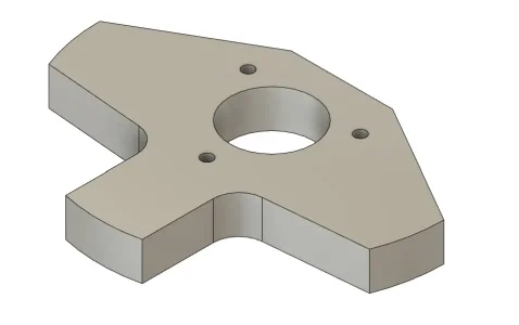

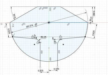

I started modeling the oil pump. It's a bit of a weird shape so it was confusing to draw. For some of the parts you have to reference other parts and drawings to figure out how to drill the holes. It gets confusing. The drawings and written instructions are not always clear. It's possible they are clear though and I just don't know what I am doing. Drawing shapes and then trimming away your reference points can be risky. Still lots of slots and holes to make. Then I'll have to model and fit the gears.

Do you have the Hodgson documentation binder? from what I've seen its as good as it ever gets, albeit more machining sequence. Other engines are basically drawings & very miniscule instructions ranging from nothing at all to sparse LOL. My Ohrndof 5-cyl fit on 2 pages & it was in German. Well, keep at it, I suspect it will slowly sink in especially with the HMEM build posts. Its a good habit to build subassemblies of inter-related parts. Sometimes that makes geometry more meaningful, this mates to that, this hole lines up to that hole etc.

I do have a full set of plans. I purchased them from the son of the original designer. So they are legitimate. I find some of them to be clear and some not so much. I think some of the references are for a specific piece of equipment that would be used in a manual shop. I'm going to be doing all the drilling on a CNC mill so it would be nice to just have instructions based on distance from centre and clock angle. I do agree with what you say though about it slowly sinking in. I can better visualize how things fit together from a solid part than a paper drawing. I find a computer model to be in the middle for me to understand things.
