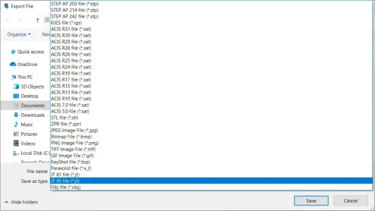

That's why my Office 2010 can still read office documents and spreadsheets etc. created by newer versions? The decision to not have a "Save As Version" with the potential loss of information is always possible and much as people might not like Microsoft they've had that feature for a really long time. Go into Alibrev and the Export file and look at all the different revisions for other software packages that they support.
But no support for older revisions of Alibre files. It's a choice that has nothing to do with things getting old. The sooner we stop buying that crap from suppliers the sooner we will get stable, faster, smaller software with fewer bugs rather than constantly changing software that requires a maintenance agreement just to fix all the stuff they introduced with "upgrades to enhance your user experience"

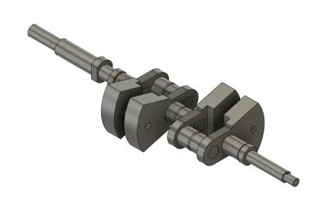

Crankshaft for the radial engine. I originally drew this in solidworks. Out of curiosity I imported the assembly into Fusion 360 to see if it would work. It worked flawlessly. This surprised me because solidworks won't even import a newer version of something drawn in it's own software. I will probably redraw it in Fusion 360 to keep things consistent.
I did the same sort of thing with Alibre when I first started. I already had my Gingery Lathe made from castings etec. But for an exercise I took the 2D drawings and sketches from his book. Then from the 3D part even able to recreate the 2D drawing. Sometimes it's easier to learn something by drawing something that already exists than to start from scratch for something that doesn't.
