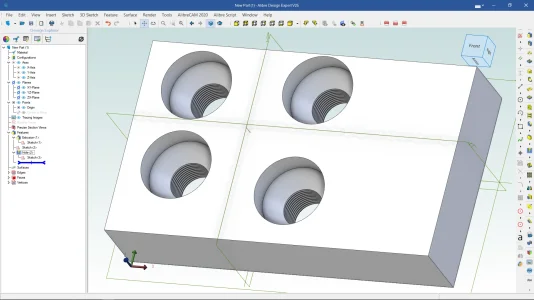

The attached shows a V block for my Nikon 6 Shadowgraph. I printed the t-nuts, M5 thread. Without chasing with a tap they are snug right out of the printer. Ditto with the clamp. T-nuts are 3.7mm tall so not your usual milling machine size.
