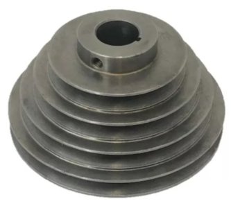

I ran across a 7/8 shaft 4 groove pulley on ebay for a myford lathe. It's expensive especially when shipping from the UK is factored in. I'm guessing it's no good to me anyway because it scales like a 3/8 belt if the photo is right. But the pulley has a shoulder at the motor end which got me to thinking a bit more along the lines of @Brent H's suggestion.
Why couldn't I machine off the smallest groove on my existing pulley to make a stub like that. It would leave me with only 3 grooves of adjustment - all a bit faster than original, but as @Dabbler suggested a while back with the back gear issue, I have a VFD and a VFD rated motor so the truth is that the missing adjustment groove is not really a problem. Most likely, I'll put the belt on the second highest speed groove and never move it anyway!
In fact, why bother machining off the small groove? Just push the pulley back on the shaft one groove and go! And yes, I have confirmed that it easily fits the housing when I do that.
I might need a longer belt, but 1/2" v-belts are dirt cheap and available everywhere - I even saw a variety of v-belts at the convenience store!
I'll keep looking for a pully with a motor side shoulder like the one in the photo above, but the truth is that this issue is now behind me.

Moved the VFD to the Hartford Motor today. Man is that motor ever smooth!
But the pulley introduces a bad vibration at 60Hz. Prolly caused by the extra grub screws I installed. It's ok at 55 and below as well as 65 and above.
Guess I'll be taking a closer look at that thread on balancing a 4 jaw chuck.......

My wife and I drove to Kitchener and back yesterday so I had very little time to play. However, I did take a half hour before bed to put the top housing on the motor with a new longer drive belt to check adjustment clearance. I couldn't resist running the motor. The damping inherent in the drive belt has almost clobbered the vibration.
My wife came out to the shop and I ran it for her too. That 4k scream made her practically claw her way through the wall of the shop.
If I get some time today, I plan to tune the VFD a wee bit. At a minimum I'll increase the carrier freq till she can tolerate it. But what I really want to do is switch to vectorless control.

I did a little more VFD tuning today.
I could not get SLV to work properly until I discovered that my modulation was set to 2-phase Pulse Width Modulation. My manual, says that's the factory setting. Go figure. Anyway, changing that to 3phase PWM cured a whole host of issues and also allowed me to run SLV.
Between adding a belt, upping the carrier freq to 12khz and changing to 3ph PWM & SLV, she purrs like a kitten.
There is still a low freq noise there that happens below 43hz, but its totally tolerable. Maybe I can fix that too with additional tuning. We will see.
In the process of doing all that, I noticed that the low/hi speed spindle clutch actually raises and lowers the spindle pulley stack too. With my current motor pulley position, the belts line up nicely when the spindle pulley is down, and it's offset about a 1/4 inch when it's up. I don't like that. So I think I'll steal back half of the 1/4" I thought I could buy for the keyway and split the difference for the clutch as probably originally intended rather than using any of it for the pulley Keyway.
FWIW, I think this discrepancy explains the 1/4 difference between my measurements and @Dabbler's. My spindle pulley was probably down while his was up when measured.
