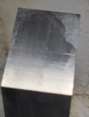

I took 20 thou off all in one pass side milling 1" of steel. I know that's pushing it but I wanted to see what it would do. Might as well have been slicing butter. The horizontal line is where I stopped just leave a mark to show that it was all one pass.

But you are both right. That first steel was simply amazing! I've seen lots of machinists using mills in my life. I've never seen anything cut so smooth, so quiet, and so effortlessly. My mind damn near snapped shut right then and there.
