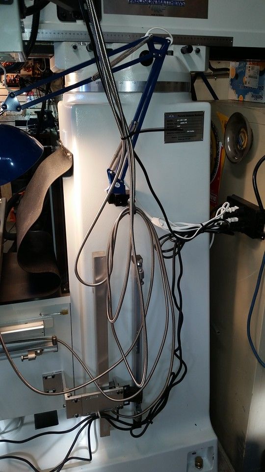

I installed the quill DRO that was on my old mill. I made a new plug to fit the quill stop. It has M5 female threads so it can be attached to the sliding part of the scale. It drilled and tapped a through hole in it at a 45 degree angle for a M5 set screw to retain it in the quill stop. I had to drill 1 new mounting hole in my bracket as the original screw hole did not line up with the hole in the new mill.
Someone was asking on another Bridgeport/clone post about mounting a shorter typical X,Y DRO scale on the quill & plug it into a 4th port on DRO box. John's picture shows why that's a PITA if even possible. Even with smaller scale systems there just isn't much real estate to mount brackets & scale & encoder cover without interfering with other mechanical things. The dedicated vernier style quill kits are the way to go. Nice clean installation, access to stop nut, no cables to mess with. There is one thing I learned on mine & that is to run a DTI up & down the scale to ensure its aligned to quill movement so there is no scale misalgnment or tension in the reader head. Sometimes the casting surfaces aren't as reliable as one would assume so might needs bit of shimming here & there. On that front, one trick I saw was to drill set screw holes in mounting brackets so you can micro adjust them in & out to correct plane geometry relative to casting surfaces & that does away with washers & shim stock. Its kind of situation specific but its a good idea IMO.
I checked both the bracket then the scale with an indicator. I got the bracket perfectly square side to side with .010" deviation front to back. The scale mounts to the bracket with 2 z shaped sheet metal mounts so I checked the scale in bothe axes and was able to get it perfect side to side with just the slotted holes but I needed a .025" shim behind the top z mount to get it perfect front to back. Then I measured the distance between the scale slider and the quill stop plug and turned a piece of 1/2" aluminum rod to match that distance so there is no twisting force on the scale throughout the entire 5" of quill travel.

I was struggling with mounting the Z axis DRO scale and power feed stops with the brackets supplied with the kit so I emailed PM and Matt replied with a bunch of pics showing how they do it in their shop. Those pics really helped. I did custom make a couple of bracket parts to make my setup more compact but the mounting concept is the same as PM's. I screwed up when I mounted the Y axis scale, I did it the same way I did my old mill. I noticed how PM does it in the pics that Matt sent then realized why they do it that way. I'm going to change mine and I'll post that change when I do it.

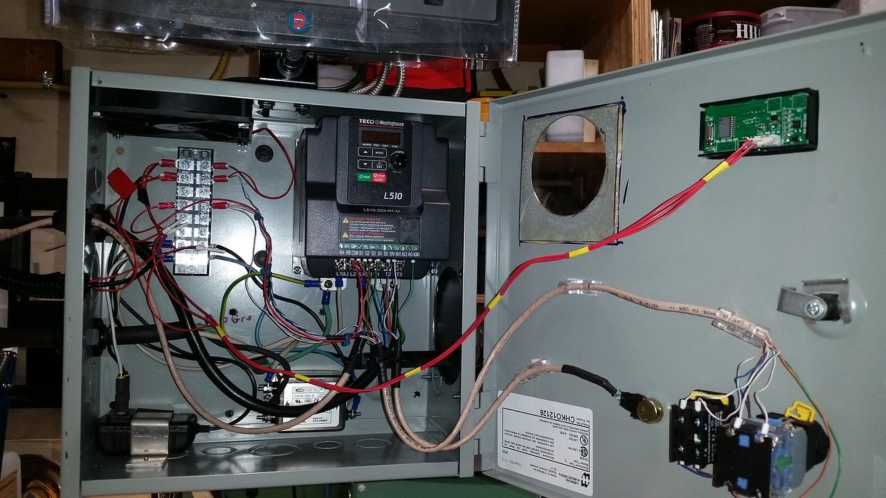

The last bit of work on the VFD was installing a brake switch. With this switch input to S4 of the VFD it will enter "base block" mode as Teco calls it. This mode allows the spindle to coast to a stop so the mechanical brake can stop it as fast as I want and will not conflict with the normal deceleration times.

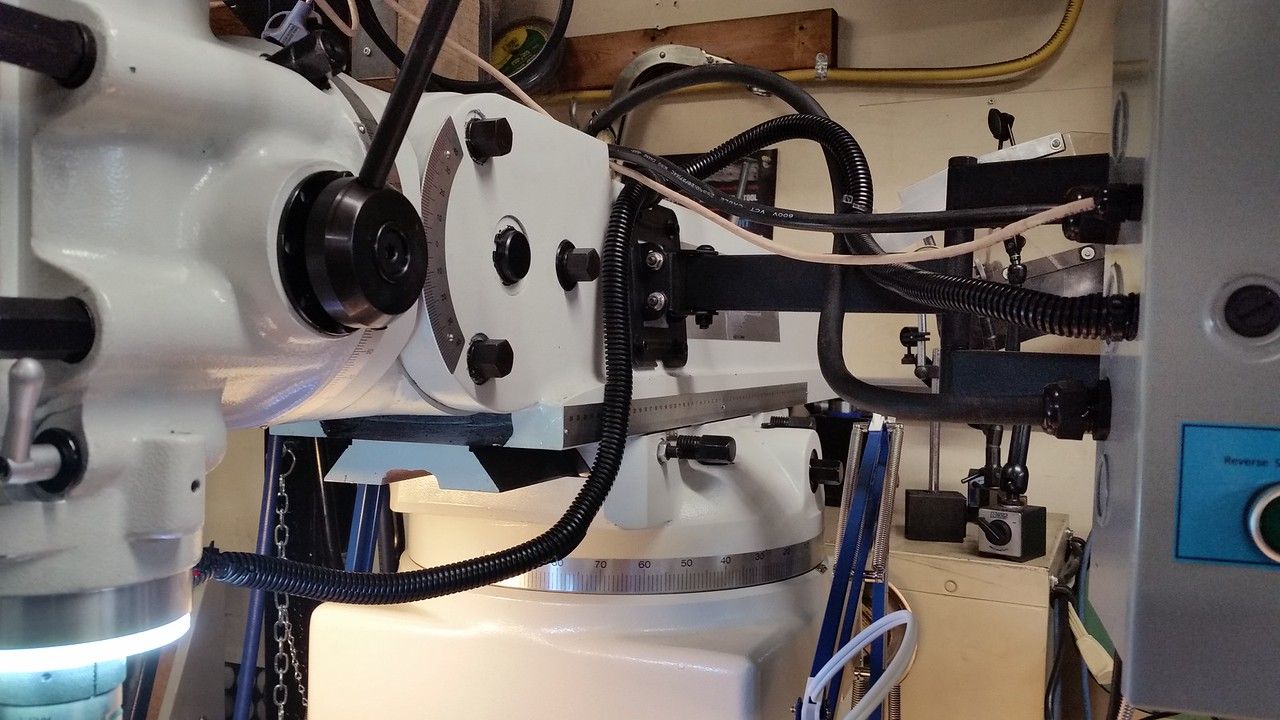

I fixed my screw up on the Y axis DRO brackets. The way I did it the first time , the X axis power feed would hit the DRO scale bracket before the table achieved full travel to the left in the X axis direction. I had to shorten 1 L bracket and make up a block to mount to the bottom of the saddle. It got me an extra 1.25" of table travel and will prevent accidentally crashing the power feed into the brackets. This is how I did it the first time.

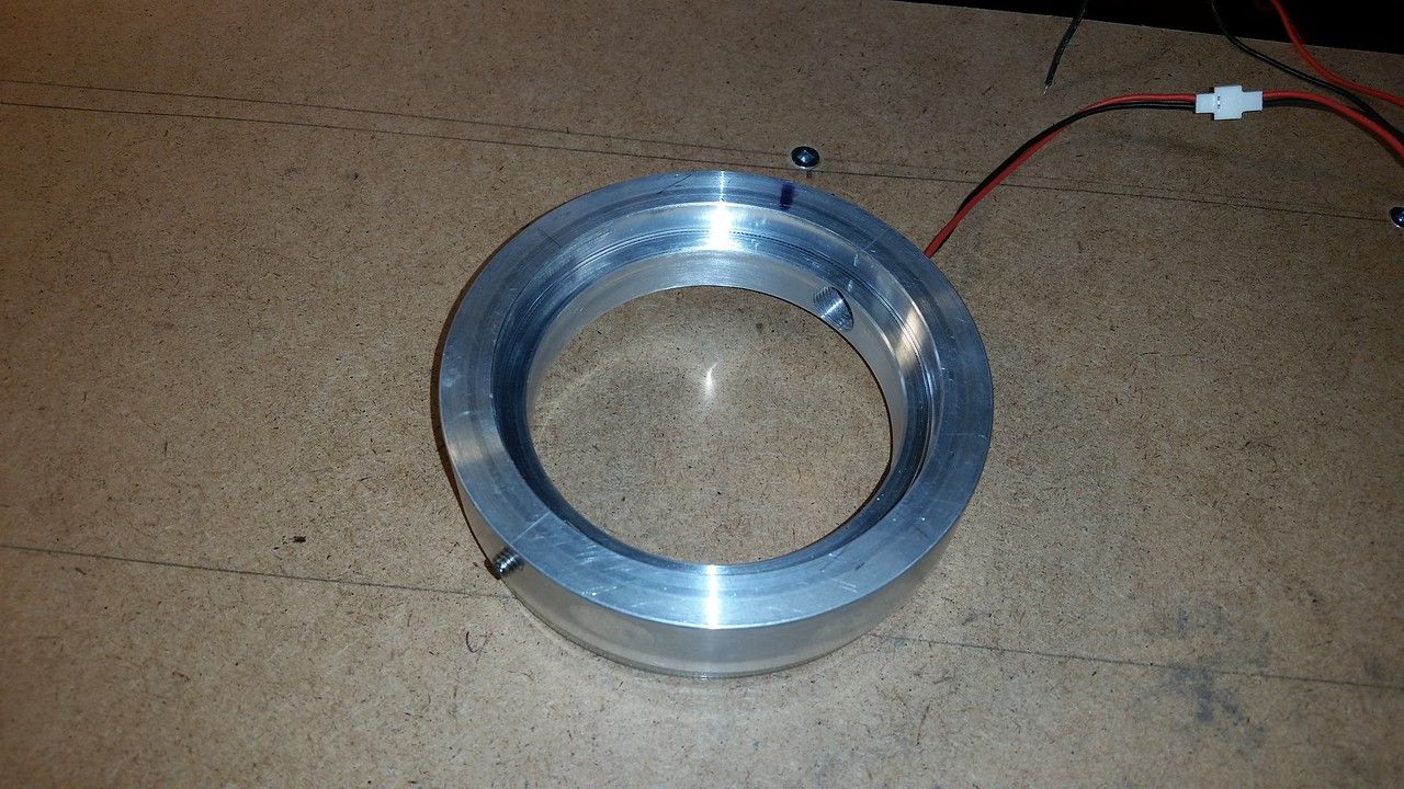

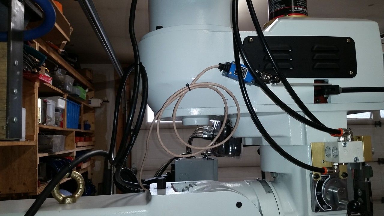

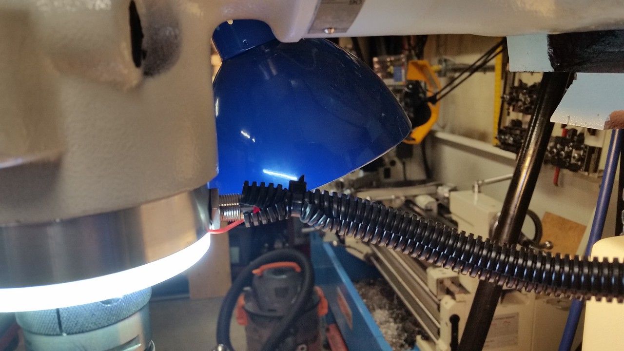

Since I already had the parts machined and a spare digital tach I installed the spindle tach, the design was copied from one made by David Best on the Hobby Machinist forum. I'm concerned that chips will stick to the magnet on the spindle collar and cause problems but it's easy to remove if I don't like it. The collar is cast iron and is a slight interference fit onto the spindle, just a little heat with a heat gun and it slides on but it also has a back up brass set screw holding it. The magnet is attached to the collar with JB Weld the same as I did on my lathe. The sensor ring is aluminum and is a slight interference fit over the nose cap on the quill but also has a stainless M5 set screw holding it in place. The light ring is a 100mm LED halo light from Amazon and is held to the sensor ring with 2 sided tape. I drilled and tapped the sensor ring M12 X 1 so the sensor screws into it and has a jam nut to keep it from moving. There was no plug/wire harness with this tach so I soldered the wires directly to the pins on the back of the display. I shot a short video and you can see it functions fine and the speed agrees with the hand held tach I have. The harness with the tach sensor and light ring wires runs straight out the back of the sensor ring and I covered it with 1/2" split loom for protection. The design is pretty light duty and has lots of potential to fail since the whole thing moves up and down with the quill, time will tell.

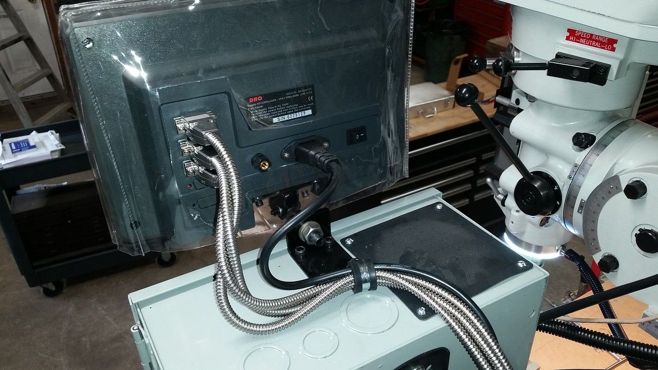

I also did a little cable management, more to come.
