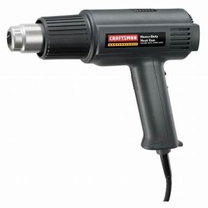

Last thing I need is a 4th battery system (~US$300 including battery & charger); besides, I already have a better Craftsman (yes, it's corded but has an extra long cord):
Higher max temp, two fan speeds (lowest higher than DeWalt fixed), infinite temperatures between 120°F – 1,050°F, six temperature indicating LED's.
no longer made, but available used.
