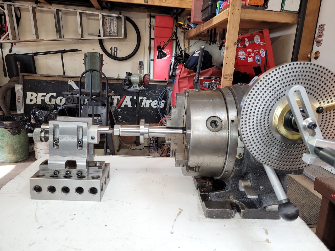

Peter, you made me nervous that the 42 tooth gear was going to be too big to fit on the headstock/top shaft so I pulled the gear train apart and did a test fit. It fits with a couple millimeters to spare! I would have been pretty upset with myself if I cut all the teeth and the gear wouldn't fit.
My set-up with the super pacer and footstock will look like this. I'll set it up on the mill the verify clearance for the cutter but it looks like there will be room.

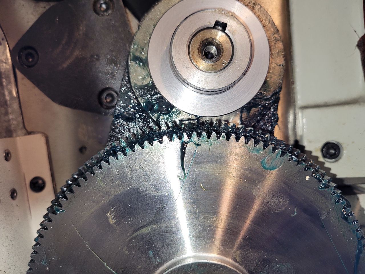

OK, I measured mine. The ID is 55mm. However, it is not a simple gear like the other two. My 127/120 has a bearing in it. The bearing is in a sleeve that is keyed to both gears, and the bearing and sleeve is retained by a snap ring.
My regular gears have a 19mm bore and they are keyed to input and output shafts that have internal bearings in the gear box of the lathe.
Edit - here is the big picture. The 120/127 is mounted on an adjustable Banjo.
The top gear a) turns 1:1 with the spindle and in the same direction. The 120/127 is a simple idler transferring the input from a) to the output b).
The output gear b) is the input to the quick change gear box which is a separate gear box from the spindle speed gear box. You can plainly see the separation between the two gear boxes in the photo.
