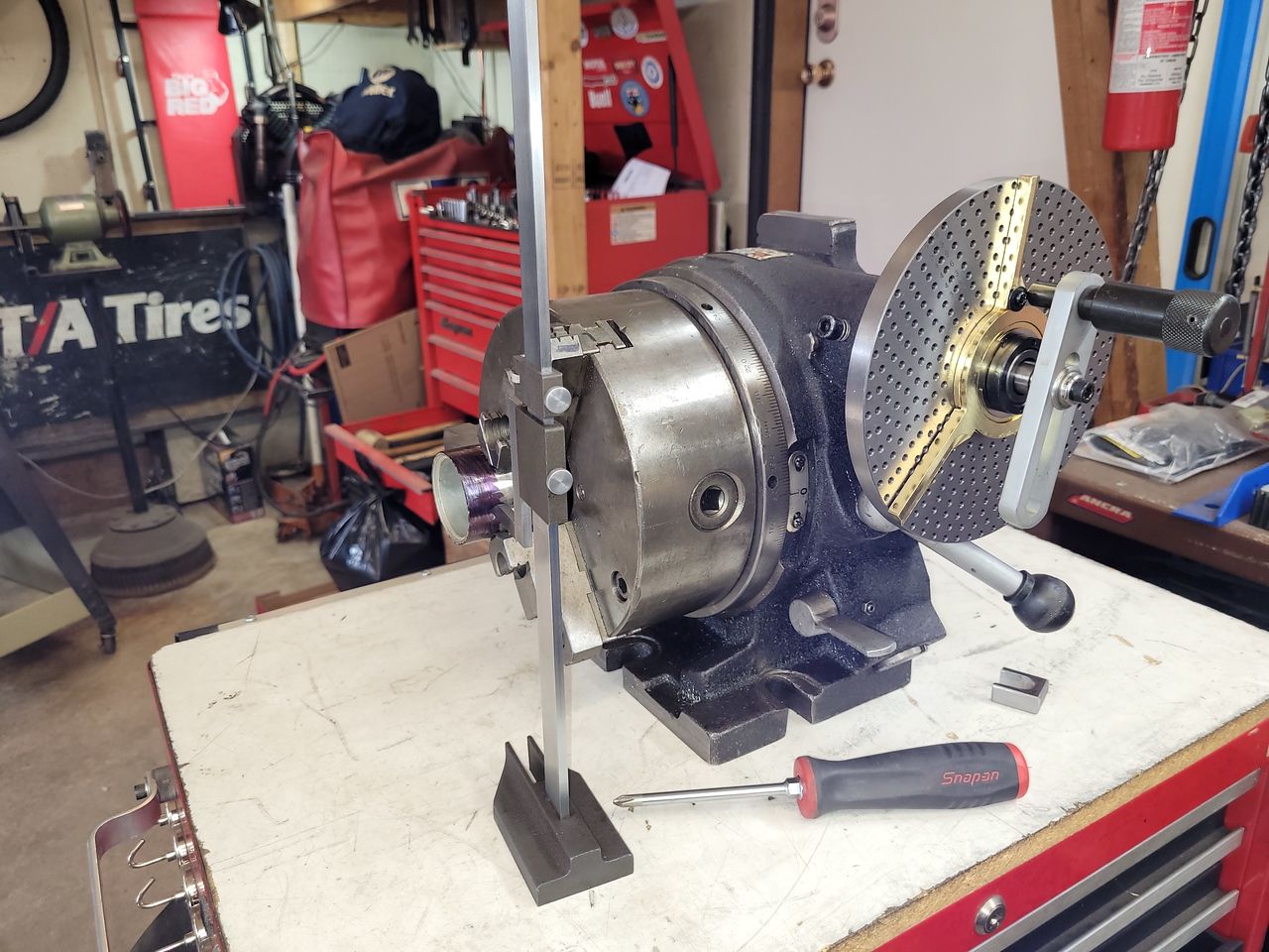

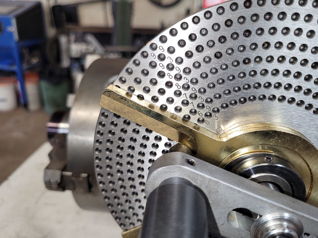

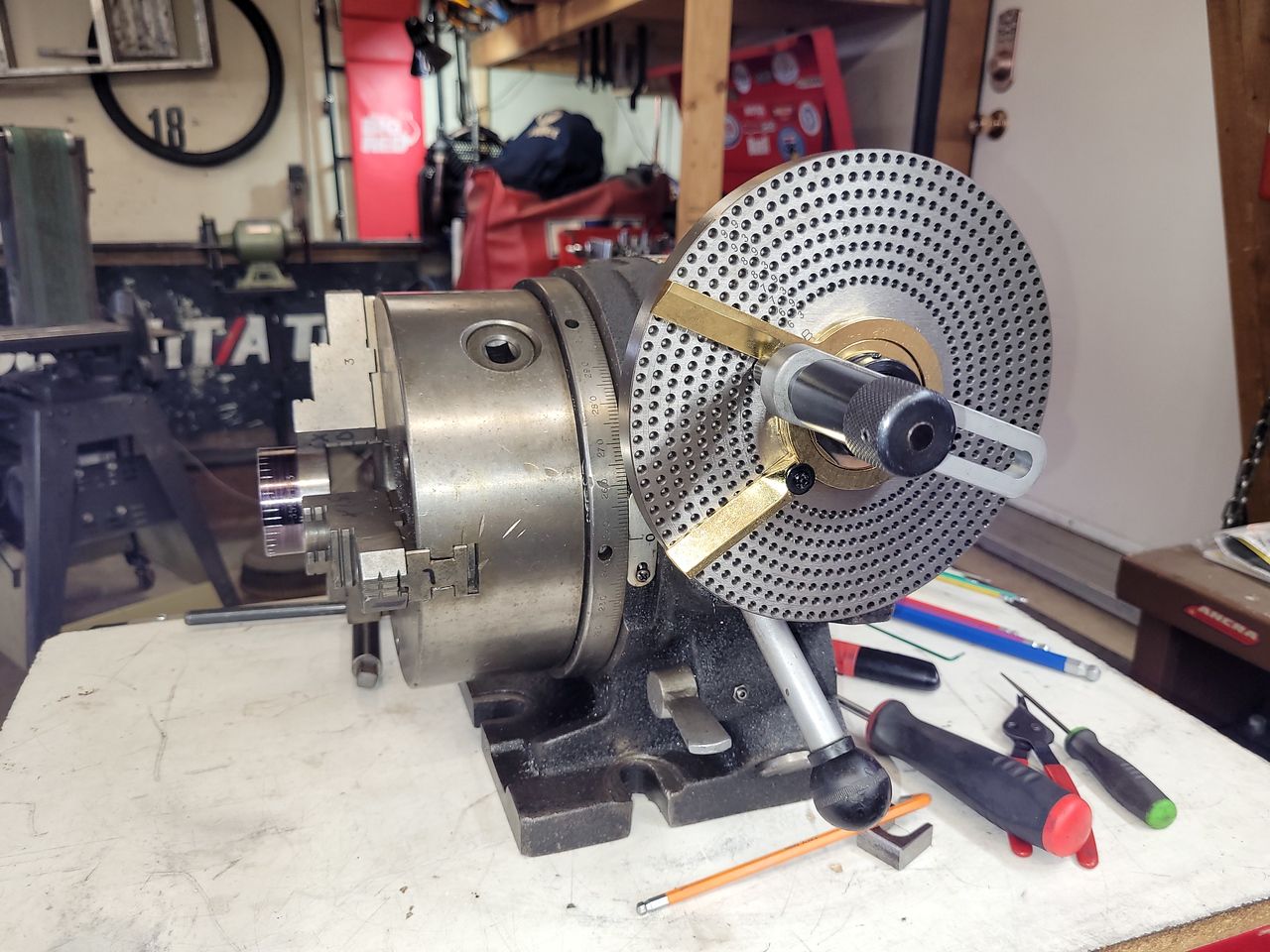

Since I have never made a gear before I want to be ready when the cutter gets here. I have a Vertex super spacer and a set of dividing plates for it. I had to brush up on using the dividing plates. Since my super spacer turns 4 degrees per revolution of the handle that means it take 90 turns to go a full 360 degrees of the chuck. The first part of the math used to find the correct dividing plate is to divide the number of handle turns to get 1 rev of the chuck by the number of divisions you want so in this case it was 90/42. Since you have to work in fractions, not decimals, that works out to 2-6/42. The is no 42 hole circle on my dividing plates so i tried 2-12/84, nope no 84 hole circle either, i tried 2-3/21, nope, then I tried 2-9/63. Yes! there is a 63 hole circle. I set up the super spacer with the dividing plate for a 63 hole circle, the crank handle must be turned 2 full turns to get the 8 degrees and then an additions 9 holes in the 63 hole circle. I made a test run with a scrap steel round and made a mark at every division point with my height gage. Amazing-42 marks was the outcome! The 36 tooth gear will be easy, just cut a tooth every 10 degrees.
Been a while since I looked at my spreadsheet but it finds the solutions based on the plates you have. Mine is 40:1. I could have sworn I made a 90:1 version but maybe not.
If you tell me your plate holes count I could probably amend it. There might be online tools too.
great, I was able to update my tool. I spot checked a few & looks like its correct. It comes up with a few other solutions depending on the gear/angle, but I doubt you'll wear out your holes LOL

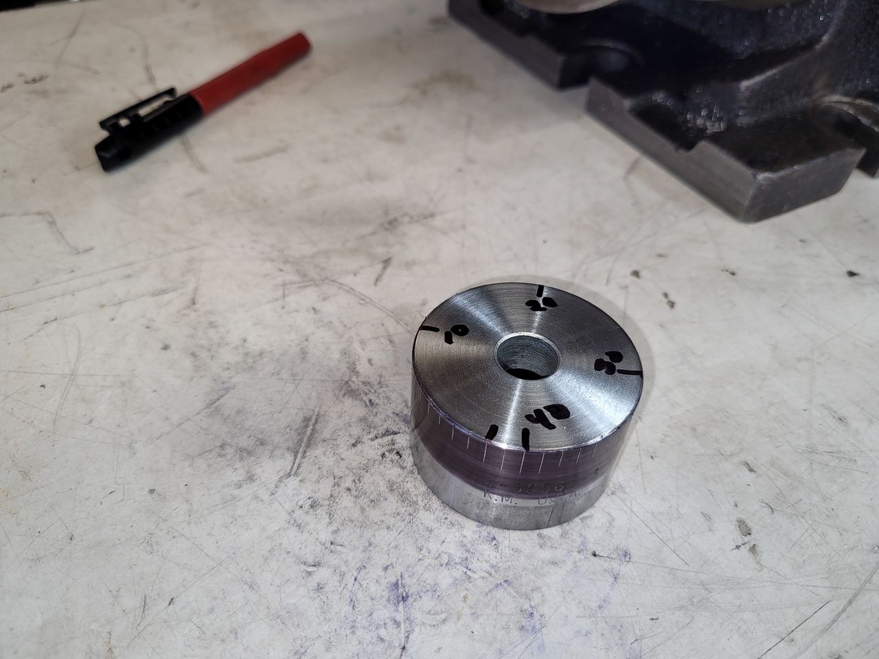

A little more prep work for machining the gears. I made an arbor that will hold the 19mm bored gear blank. It's 24mm on the end that will be in the super spacer chuck. It will be supported on the threaded end with a footstock. I still have to make a 22mm arbor for the cutter. It will also be 24mm on the other end and be held in a er40 collet chuck. I got a little single point threading practice with the 5 /8"-11 threads.
