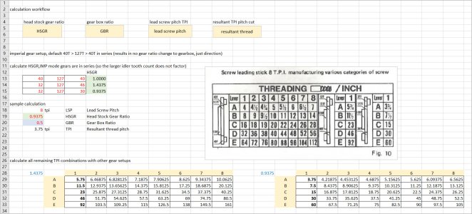

I dunno about that "like most lathes with imperial screw" comment Peter. Mine has the 127/100 set to change to metric just like you describe. But it also uses a combination of 4 other external gears (6 with the 100/127). Yes, there are 4 Knob Dials to change internal gears to further refine the desired thread pitch. But these are used together with the 4 external gears.

Mine is pretty new, and has both internal and external gears to set thread pitch. I think that's pretty common on most smaller (14 and under) gear heads.
But I lied about the number of external gears I have for mine. It's actually 10 gears if you include the 127/100. The 127/100 is always installed either as 127/100 or as 100/127. Two of the others are also always installed, so it's really 8 not 6. They are 54 57 60 60 63 66 69 78 100 127.

That's exactly what I was wondering. Its been a while since I looked at my homebrew calculator but depending on how you swap the gears around, it's possible to get different nominal pitches as intended, but maybe also possible to get unintended incorrect pitches/feeds. The plate they nail to the machine typically shows nominal sizes but not all possible sizes. Sadly, some of the common metric pitches on my machine are not possible. Too bad there wasn't an quick & easy way to swap in a metric pitch feed screw. But you'd need a disconnect coupler on the HS side, metric clamshell set, dismantle the TS side shaft block..yadayada. I'm not that ambitious, wait for @Janger to finish his ELS!

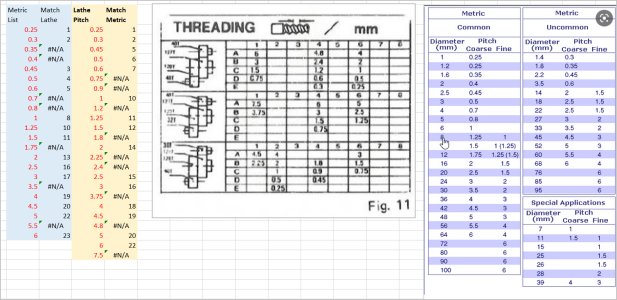

One of the first things I did when I got my second lathe was to make a chart of all the possible combinations. Just like you, that was an outcome of noticing that the factory chart had missing spots. I found a few others too.
Which common metric ones are you missing? I'd like to check mine. I promise not to gloat if mine has them.
I know sitting here right now that I have 1.6mm on my lathe. I've been told by some that 1.6mm isn't a recognized metric pitch. Yet I have seen this pitch used on several pieces of hardware, and it exists on many of my charts. I think most deniers just want to believe that its really 16tpi because they are VERY close.

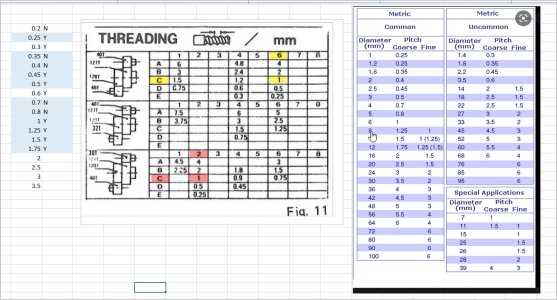

Hmm.. this is reminding me I left this project unfinished, but I think its pretty close. Where it shows an integer is a match between what my lathe can do & known metric pitch, common & uncommon accordingto the table I imported. For completeness there are some other pseudo-nominal pitch combinations lathe can do but I suspect not typical metric pitches. I calculate this on another sheet but seems like my MATCH or VLOOKUP function is not playing nice today, I'll have to dig deeper
