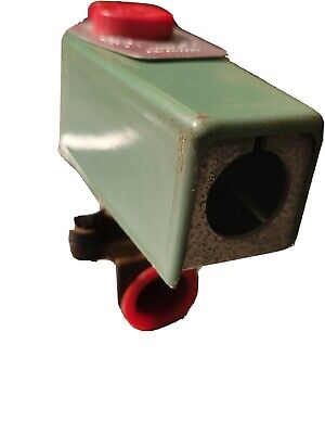

A quick ebay search showed up this valve.
https://www.ebay.ca/itm/175555685092 A little pricey.
What's the exact part number of your ASCO valve?

John,
ASCO Red Hat 8210D95, cat #JKF8210D95
Here is a used one, price is good but shipping is high. BTW, they actually sell service kits for these, (if you ever need one, not likely from what I have read )
