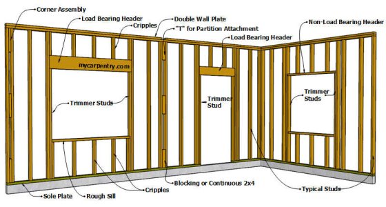

Double sill plates is very uncommon.

I find that double sill plates are often used in wet environments and on cement. Typically, the bottom sill is rot guarded - pressure treat etc.
Chicken - I think your experience is actually quite common. Exterior and load bearing walls are usually only uncovered for very short periods of time so you wouldn't notice the double top plate. But inside non-load bearing walls are left uncovered and renovations are often single top plate too. Basement insulation walls are almost always singles. If that's what we see all the time we naturally accept it as the norm. But I've never seen an exterior wall with only one top plate in my lifetime. They hold the roof rafters up and those damn rafters never line up with the wall studs. In other words, your experience is perfectly valid.

Spot on Susquatch.
Though, the sill plate they typically do at least sill gasket or sometimes vapour barrier wrapped around the bottom when it's in contact with concrete. Pressure treated less so on residential structures (since the foundation usually gets it up off the ground high enough), but for sheds and out buildings where it's just slab on grade that's more common.
Also, cement is the stuff used to make concrete...concrete is the mix of cement and aggregates that is used for construction :)
Here is your basic framing. Single sole plate - pressure treated or protected (sill gasket or plastic) if installed on concrete direct.
Double top plate for exterior walls and joints overlap at corners and where interior walls tie in.
Wall studs are typically 92-5/8” for 8 foot wall framing. Mathematically a stud is pretty much 1-5/8” thick so adding it all up you will get 1-5/8” sill + 92-5/8” + 1-5/8” x 2 top plate = 97-1/2” total wall side. This should allow you to install a full 96” x ? Sheeting onto the wall given roof sheeting may be thicker at 5/8” and thus the roof sheeting is installed and the wall board supports it at the edges and there is some clearance at the sill.
There are a few other options - bracing for walls over 9 feet, continuous studs for high walls etc etc.

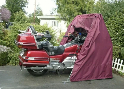

Well seems my moto shed may have hit a snag.
Municipal bylaws state:
1) no sheds in front yards. Front yard is classified as the full width of the property including any laneways or driveways.
2) sheds cannot be used for vehicle storage.
I may go talk to someone at the City Hall but it's likely a no-hoper. :(

What about a lean-to or quasi car-port or drive-in tent?
Yup, this is my next best option @Susquatch
Canadian-made, somewhat local to me on the mainland. I've had one before and they work well. Spendy things though at $455 USD/$600 CDN delivered.
I need to think about this more as I was also hoping to store my motorcycle lift in the shed. Just getting the bike out doesn't really gain me a whole lot.
