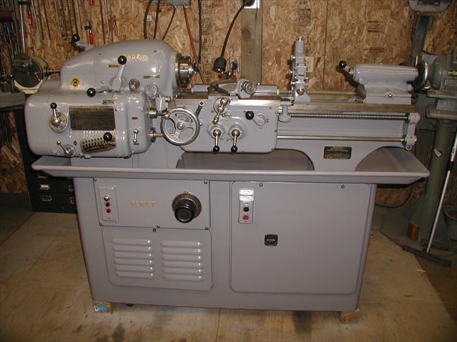

Hendey T&G Lathe
There seems to be a lot of tags and labels on the back of the headstock. Does this give you a bit of the machine's history?

It was definitely originally sold to the navy but it has other stickers on it for I think the USDA.
It was bought from a government auction in WA about 10 years ago by a guy in Montana. He had it stored in someone’s barn for years and when he finally went to see it he found the headstock was cracked like something had fallen on it in storage.
The guy I bought it from picked it up mainly for the taper attachment and replaced the headstock with one from his other parts machine.
Except for the taper attachment it’s complete and fully functional, I saw it run when I picked it up. The replacement headstock casting doesn’t line up with the other castings perfectly though.
The previous owner actually has original drawings for the taper attachment so if I’m feeling ambitious I could make one eventually.

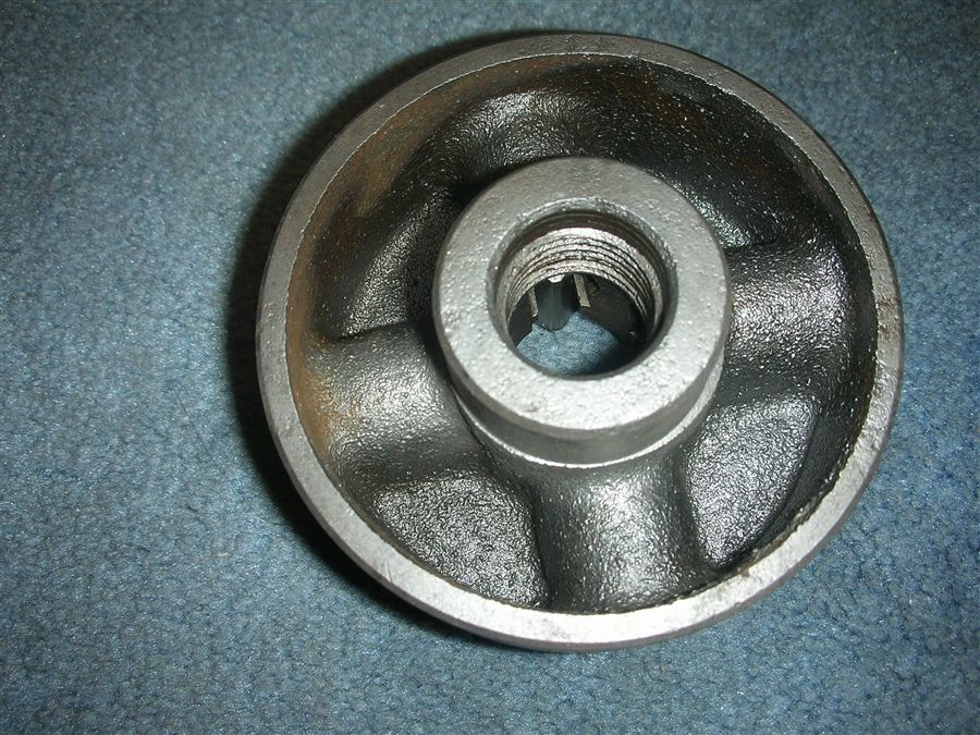

Good to see the trip went well. If you're looking for a 5" 3 jaw, HH Roberts has NOS Bison with a screw on backing plate. Remove the screw on backing plate and fit a D1-4 backing plate and away you go.
Can't go wrong for $190 cdn if the 5" will do you.

Wow, do you know if the 6” Atlas 4 jaw they have can also be swapped for D1-4?
I tend to use a 4 jaw more often so I think that should be by first chuck purchase.

If it's the same 4-jaw as the one @YotaBota showed me I believe the spindle is integral to the chuck.
